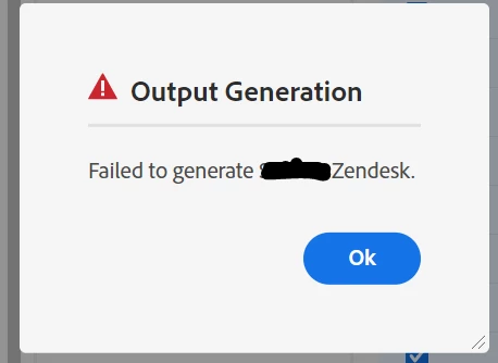

I'm having issues getting my Robohelp 2020 project to publish to Zendesk. My publish profile has Zendesk Help Center as the Server Type. I can see the appropriate selections when I use the dropdown for  "Visible TO" and "Managed By" (So the user name and connection to Zendesk is correct)  I have my articles selected that I want to publish but, I continue to get this:
What am I missing?

If you skip trying to publish to Zendesk, does the output generate fine? Has this ever worked before or is this the first time trying it?

@Jeff_Coatsworth  Sorry, what do you mean skip trying to publish to Zendesk?
Our company has successfully published using Responsive HTML5 for years. We are trying to move all our stuff to Zendesk.
My coworker (who know longer works for the company) tried this a few years ago and was able to so, I tried to follow what was applicable from her notes. I've never done it, Im starting from scratch.

Just trying to determine if it's something wrong in your project or in the Zendesk connection. Sounds like the project generates ok, so maybe it's something to do with how it integrates with Zendesk. Have you checked Peter's site for any "gotchas"? See his page on KB outputs - https://www.grainge.org/pages/authoring/rh_tour/rh2020/outputs/outputs_knowledge_base.htm

@Jeff_Coatsworth within Publish Profiles, I selected Zendesk Help Center as the Server Type. There is a Salesforce KnowledgeBase, ServiceNow Knowledgebase, and Zoho Knowledgebase... Im assuming stick with the Zendesk Help Center as thats the ultimate goal?
