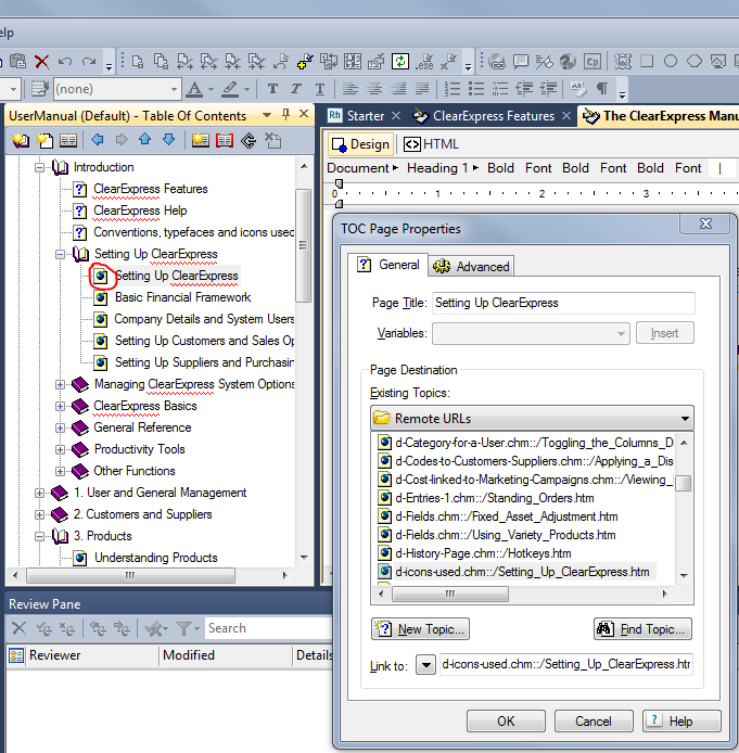

I have the same issue after upgrading from RH 6 to RH 11 (I'm trial testing this version).  The issue is when viewing TOC in the Robohelp Manager - this is before compiling.  The topic on the TOC is represented by "globe" icon and clicking on it will display the TOC Page Properties with option to select the topic to link.  I can view the TOC in RH 6 just fine.
This happens to most of the topics and there are just too many to redo them.  Below is a screenshot.
Thanks in advance for any advise.

Furthermore, when viewing the Topic Links for these topics.. they are pointing to URLs or to a CHM file.  Any reason why?  When these TOC topics have been linked to each topic in RH6, I used the specific topic link in word document.

So one thing that would be interesting to see is exactly where the links are pointing in the original file. An upgrade shouldn't be re-pointing any links. So I'm naturally suspicious. Are you absolutely certain that the links that are causing issues weren't pointing the same way in the old project?

I'm adding screenshots and for the particular topic that I chose, the only difference is that the topic has mid-topics in it as shown in RH 6 but none in RH 11.  As mid-topics are represented by hash (#) character in RH 6 and seems that this is considered as invalid/illegal character in RH 11 (there are broken links in RH 11 for my project due to # character considered as invalid character) - could it be the cause?  If so, is there a work-around?  The # character is valid character in RH 6 and there are so many mid-topics in my projects.
The screenshot above shows how I add new topic to the TOC in RH 6 and link it to a topic in a document.
The topic highlighted above has working link in RH 6.  But has none in RH 11.  Adding the link in RH 11 shows no difference as shown in screenshot below.

I think the issue here is that you not only upgraded from RoboHelp version 6 to RoboHelp version 11, but in that process you also switched the authoring environment from RoboHelp for Word to RoboHelp HTML. And something about that process has really caused things to go wonky. Without knowing exactly the steps you followed during the process of "upgrading" the project, it's going to be really super difficult to say what is breaking and where the break is occurring.

Hi Rick, I did several different processes for testing the upgrade as follows:
  1. Upgrade from Robohelp for Word 6 to RH 11.
    • Took a copy of our existing project and save locally.
    • Launch RH 11.
    • On RH 11 Starter window, click on Open under Recent Projects section.
    • Locate the UserManual file.  The file type is .hpj.
    • A pop-up message appears that there is already an .XPJ file.  Should I use the XPJ and not the HHP?
    • I tried using both - XPJ and HHP.
    • A pop-up message about upgrade will be displayed.
    • Click Yes/Ok.
    • The workspace is then displayed.
    • The TOC topic links are missing and opening the topic properties will display the remote URLs link.
  2. Upgrade from Robohelp HTML 6 TO RH 11.
    • Convert the Word documents to HTML in RH 6.
    • Launch RH 11.
    • On RH 11 Starter window, click on Import>More.
    • Click Yes/Ok.
It could be something to do with the file types.  Upgrading to RH 11 is already going to create more work for us for the context-sensitive configuration.  I wouldn't want to restore the TOC topic links manually if I don't have to.
