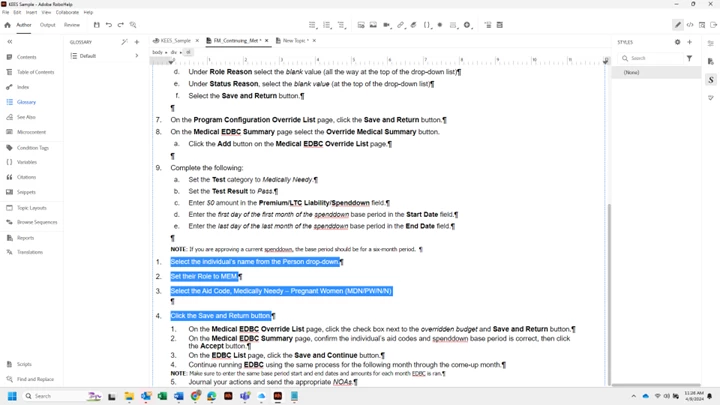

I am working with Multilevel lists in RH 2022.  I've imported a document from Word into RH.  I have created my list style and configured it for 4 levels (3, actually is all that is needed.)  I'm going through my imported file and I'm trying to apply my list style to the parts of the document that need the numbering.  Things are going great in some parts of the document and then in others, I am unable to use the Tab key to move the lines to the next level.  I select the lines that need the numbers applied to them, and select my list style that I created called KEESMultilevelList and then I press Tab because I need it to be a level 2 and nothing happens.  Earlier in this same document, tab works and allows me to move the lines in to the next level.  I've looked at the CSS source code and I have no idea what the hell I'm even looking at.
In addition to this problem, I also have a strange issue where these random paragraph markers appear in my document after I apply the list style.   It doens't do it every time I apply my list style, but when it does happen, I can't select the paragraph or back space it out or delete it.  It just won't go away.  I've attached a screenshot of the topic as well as the original Word document and my CSS file.  You can see that under 6f, 8a and 9e there is a paragraph mark and I can't get rid of it.  Initially I thought it was something to do with  my level 2 but then I noticed it happened afte a level 1 as well.  I need to remove those empty paragraphs.  Things I've tried is to delete the lines in the level that I was trying to apply when the paragraph appeared and reapply the list style - it just puts it right back in.  I've tried the clear formatting in RH.  I also went back to the Word file and copied the text and pasted into Notepad and then copied again and pasted into my RH Topic and it does the same thing.  I've also tried the None list button on the toolbar at the top of RH.
So, my 2 questions are
1)   Why can't I use the Tab key in certain spots to go to the next level of my list?
2)  How can I remove these empty paragraphs that are being inserted when applying my list style (and     how can I avoid the empty paragraphs from appearing or can I)?

    I think the blank paragraphs are normal and mark where a nested list ends. They won't show up in the output.
    As for not being able to nest a list, it usually means that the text isn't a list, or is a complete list rather than part of a list. The screenshot is a bit small, but the selection of text you selected seems to be inside a div, so you might be trying to indent the div, rather than the list itself. Or perhaps you have selected a complete list, so you won't be able to nest that until you include it as part of the preceding or following lists.

    Thanks, Amebr.  You were right about the blank paragraphs.  You can't tell in the output.  So, now the only problem I'm having at this particular time is the tab button not working to move level one to level 2.  Like I said, it works in some places, but not all the time.  Something obviously is in those lines that is causing a problem.  I'll reread the suggestions on this post and see if I can figure anything out.  Thank you.
