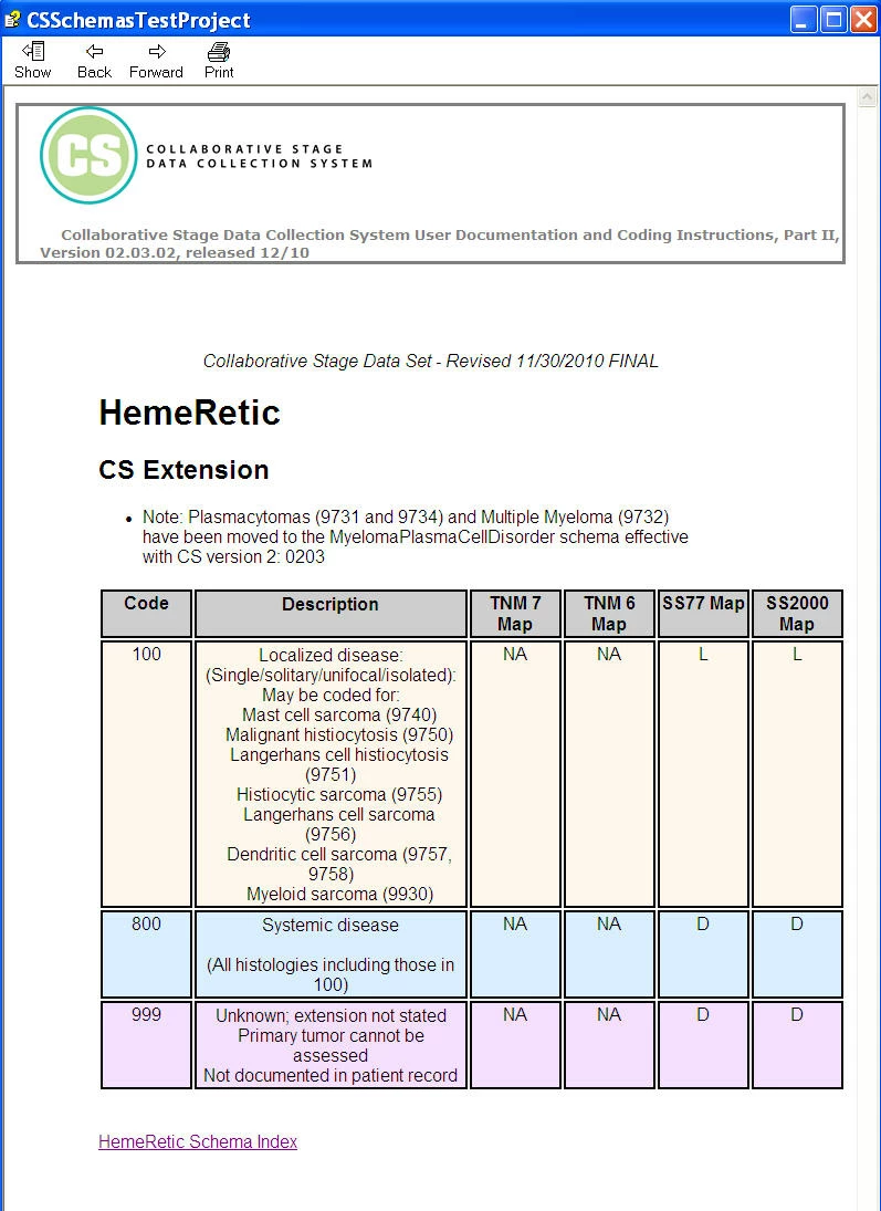

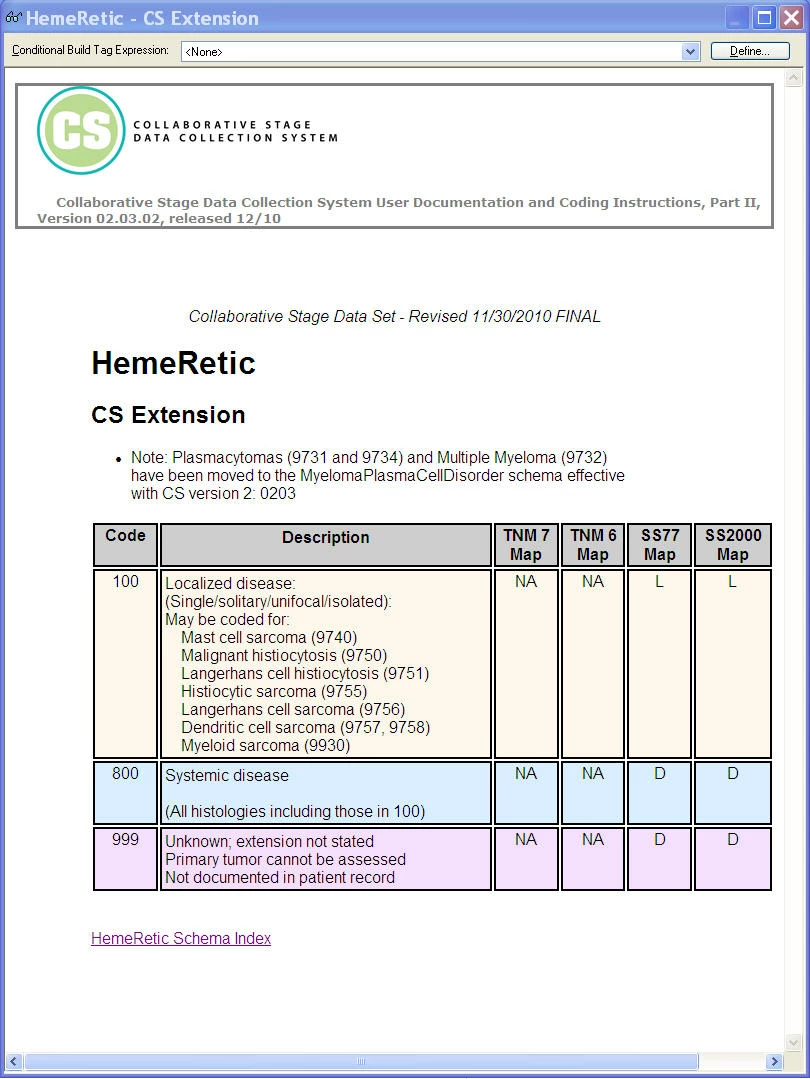

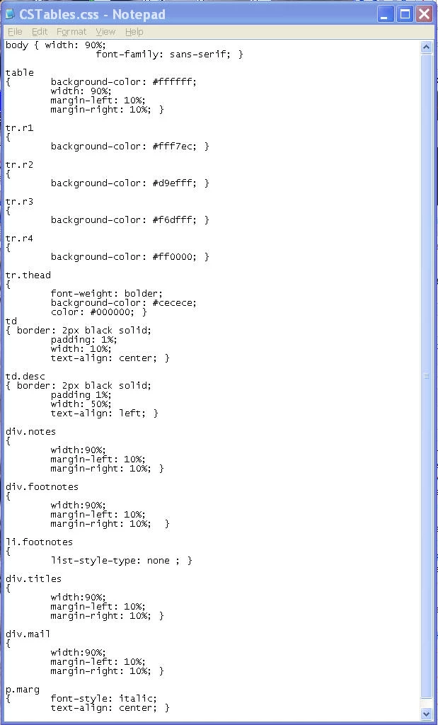

I’m using RoboHelp HTML version 8.  RH8 is dropping a style from my stylesheet.  The style appears to be applied correctly when I view a topic (the HTML file) directly with either IE or Firefox browser, and it appears correctly when I view the topic with the “Item View” feature in RH8 (the eyeglasses icon).  However, in the compiled HTML help output from RH, the style is not correct.  The style in question is a class of style (“desc” for descriptions) for a subset of table data. The “desc” class should have the data in the cell left justified, and the cell width should be 50%.  The main parent style for table data (centered text, cell width varies) seems to be applied instead, and the child style for descriptions is not applied.  Below I've included a screen shot of a table page as it looks in Item Viewer, then the same page as it appears in the CHM, and finally the style sheet in its original state before being added to RH.

Unless Willam has a better idea (quite likely) why not create a paragraph class such as p.desc and apply that to the content of the cells?

I don't see any problems with your css. Can you try to unpack the CHM and open the topic with Internet Explorer? Does that give you the same result as when you view it in the CHM? Also, check that the style is available in your CHM style sheet. You can unpack a CHM file with the Microsoft HTML workshop.
The reason I ask is this: When outputting to WebHelp, the topics are created in XHTML format. This format sets IE to run in standards mode, thus correctly displaying your table. In a CHM, topics are saved in HTML 4.01 frameset, thus setting IE to render in quircks mode. As CHM uses (some part of) IE to render the contents, the problem might arise from this.
