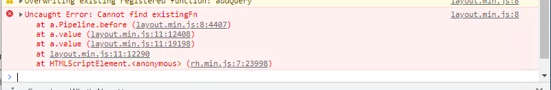

I have an issue with the search not working in the current version 2020.7.46 for my existing project. It is a merged project and I am using an responsive HTML5 output. I only see the loading spinner, no matter how long it takes.
When I create an output of the parent project, the search works.
When I create the child project and call the help directly from the output window (using the eye icon), the search works exactly 1 time. After that or when I move to the main page of the output, the search is no longer working. The following error message is displayed in the console:

    April 28, 2022
    Update:
    The problem seems to be caused by the project language setting. It works, if the setting is English, it doesn't, if the setting is German. Then, the problem is also reproducible with the sample projects. I just checked on this with Adobe Support and they will look into it.
    I will update here any news.

    April 29, 2022
    Sorry for not having been clear. No, for standalone projects, I could not detect this problem. It only occurs for merged projects when the language setting for the child project is German. The language setting of the parent project does not seem to matter.
    April 26, 2022
    Thanks Peter, I will contact support and update here.
    Just for clarification: The search seems to work, when the child project is opened from its direct mergedProjects/childProject path using the index.htm that is stored there. Then, the subproject opens with only its own TOC and here, the search works. When clicking on the header to load the entire parent project, the error message from my screenshot is returned in the console and after that, the search no longer works.
