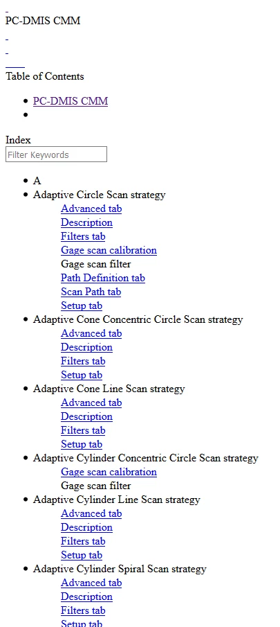

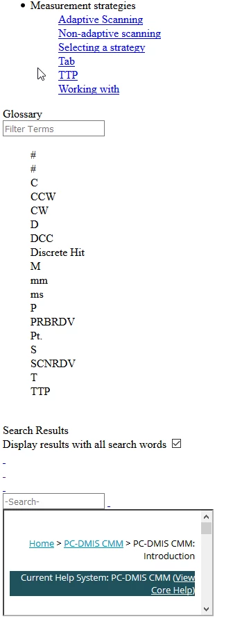

However, when I view index.htm from the generated output location in my browser, I see this:
At the top of the index.htm pageAt the bottom of the index.htm page
Weird that the topic appars in that little container at the bottom of the page, huh? Anyway, this makes me think the script that makes everything work is missing or doesn't work from an RHCL build. The problem appears to just be with index.htm.

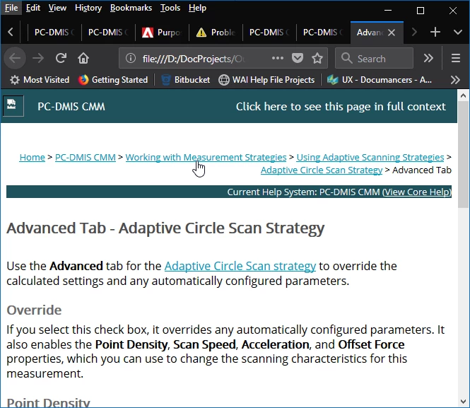

If I then access just a topic by itself (outside of full context), meaning without using index.htm, it displays fine:

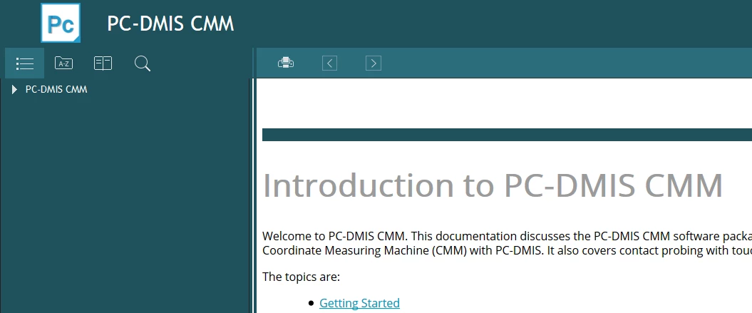

And here's what index.htm should look like (This is what I get when I generate by hand directly inside of RH):
