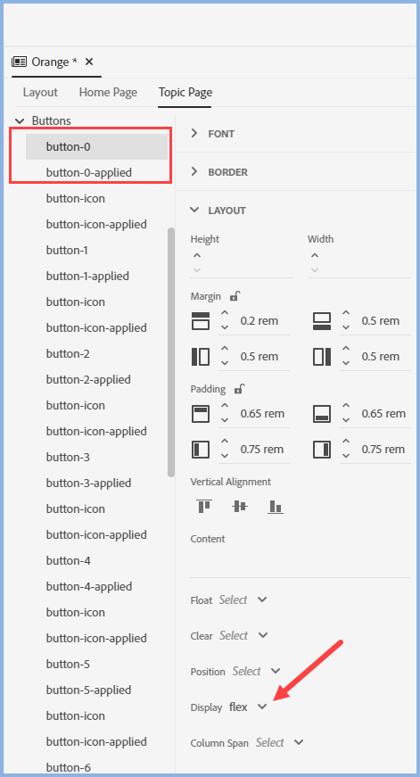

Try changing Flex to None for both buttons. I haven't tested it but believe that is the correct solution from another issue I had. Certainly in the Skin Editor it hides the button.

Thank you,
I changed the Output > Layout > Display setting from Flex to None. The bookmark and filter buttons display as expected in the Skin Editor preview, but in the output the filter button is still missing. I also tried different display settings for button-2 since the filter icon appears linked to button-2, but that didn't make a difference. I returned the button-2 display setting to the original setting: flex.  This seems to be similar to issues previously reported with the changes showing in the Skin Editor preview but not in the output.
