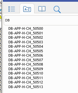

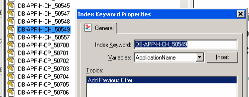

I'm generating a Responsive HTML5 Help project. I've got several keywords in my index that don't appear in the compiled Help's index. Can anyone suggest how I can resolve this?
Here's a screen shot of my Index pod in RH:
Here's a screen shot of the Index in the compiled Help. You can see that DB-APP-H-CH_50549 is not appearing.

Are any of those 50545 onward ones showing up?
June 11, 2018
Thanks for answering me so quickly, Jeff. I only get a few entries after 50500. There are several more that should be there, but they're not showing up.
To add this to the index, I right-click the text (DB-....), then click Add to > Index Keyword > Topic Index Keyword.
June 11, 2018
Ok, any difference between those that show up & those that don't?
I don't see any differences in the Index Keyword Properties for the ones that are showing up and the ones that aren't showing up.
This one is showing up
This one isn't showing up:
