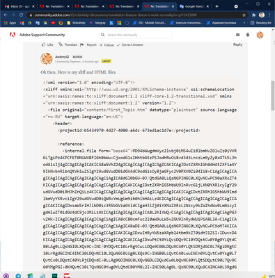

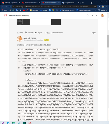

Explorer ,
Oct 05, 2021 Oct 05, 2021
Adobe Employee ,
@AndreyGl, Thanks for the screenshot. However, I did not mean a screenshot of RoboHelp, but from the source code of the translated XLIFF file. Alternatively, you can copy a small snippet from the translated XLIFF file and paste it here.
Here's how to do it in a few simple steps:
1. open Windows "Editor" (aka "Notepad") or any other plain text editor.
2. open the *.xlf file in it.
3. search for <body>.
4. mark an exemplary translation unit, i.e. <trans-unit> to </trans-unit>. Copy it and paste it here in a post. It should look like the one in my post from earlier.
Then we can see how the XLIFF file was translated, and infer what went wrong with the translation.

Explorer ,
I try to upload the code here for the third time, but it gets deleted. This is how it looks to me right after loading.

Psst, @AndreyGl, that's not a screenshot of your XLIFF file like @Stefan Gentz asked you to check. Try again to check what he's looking for.
Explorer ,
Plobably like this
Adobe Employee ,
Yes, like this. Just please do not paste the whole XLIFF file content here. Just an example of one <trans-unit> 🙂

Adobe Employee ,
Okay, but even the translated XLIFF file is broken.
In your file it looks like this:
<trans-unit id="/html[1]/head[1]/title[1]" resname="Title">
  <source xml:lang="ru-RU">Первая тема</source>
  <target state="translated">First topic</target>
</trans-unit>
But it would need to look like this:
  <seg-source>
    <mrk mtype="seg" mid="1">RoboHelp Test Document</mrk>
  </seg-source>
    <mrk mtype="seg" mid="1">First topic</mrk>
  </target>
</trans-unit>
