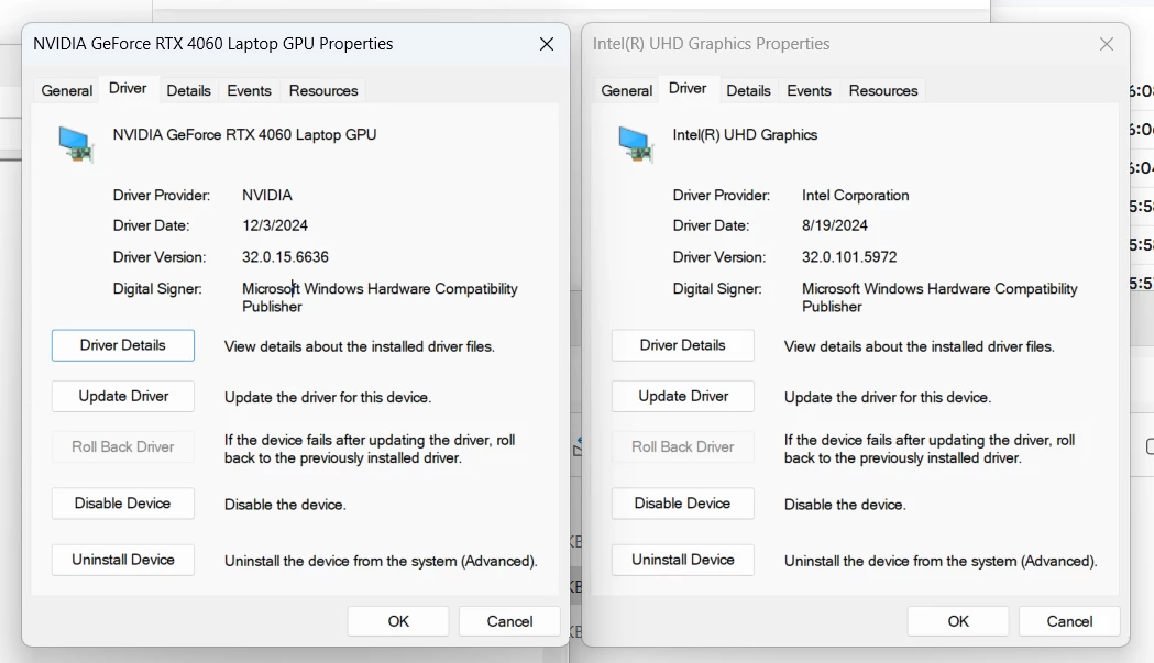

Simply posting " 566.36 " which is the way the driver number is written out (and yea, that's weird but oh well) ... in the web browser immediately pulled up a bunch of issues with black screen, overheating and such.
Roll back or move forward on the driver.
Everyone's mileage always varies ...

Jan 29, 2025 1:15 AM UTC
Drivers below in image.

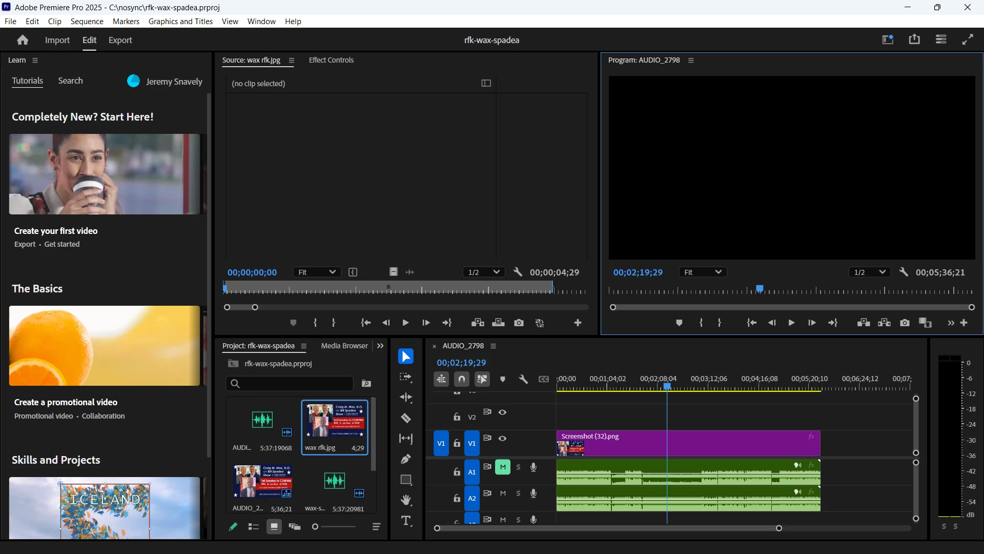

jersnav
Jan 28, 2025 3:51 PM UTC
There is no video displaying in my program monitor, only black.
Specs:
Premiere 2025 on Windows 11 Home 24H2, OS Build 26100.2894
HP Victus laptop: with 13th Gen Intel(R) Core(TM) i7-13700HX 2.10 GH, RAM 32.0 GB (29.7 GB usable)
Display Adapters are Intel(R) UHD Graphics and NVIDIA GeForce RTX 4060 Laptop GPU.
If I force the Intel UHD Graphics device to use the generic Windows display driver the problem resolves. But this is a workaround, not a legitimate fix.
Any other ideas?
Thanks!
R Neil Haugen
Jan 28, 2025 5:59 PM UTC
What media, and what GPU driver do you have?
