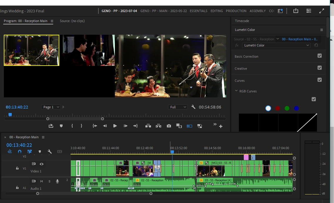

1. Version 23.5.0 (Build S6)
2. Alienware Area-51m Laptop running Windows 11
3. Have 2 separate 2 hr-long multicam sequences with 4 cameras each, then create a timeline using one of these sequences, primarily. Edit a few parts here and there to skip awkward pauses, replace a few scenes that didn't go too well with a part from the other timeline. Keep playing through, switching cameras and making live recorded edits. Occasionally pause and click one of the other multicam options to change the current edit to that camera.
4. The expected result should likely happen at first, and for an unknown amount of times, which is that when you pause playback and click one of the other cameras, the yellow outline switches to it, and it appears on the main screen. No new cuts are made in the timeline, and instead the whole current clip switches to the selected angle. The actual result is that when you click a camera angle, suddenly the angle options disappear and the preview centers itself. It doesn't appear to enlarge to the largest possible preview, retaining the multicam aspect ratio. But the other angles don't appear.
I've gotten about an hour and 15 minutes into this 1.5-hour long edit, and only just recently do I start getting this issue.
As you can see below, Multicam view is selected. If you open the wrench options list, you can confirm that Multicam view is supposed to be enabled.
At first, I could pretty quickly get my multicams back by toggling the "Multicam" icon. Sometimes selecting a camera wouldn't trigger this error. As I continued editing, though, this problem just kept happening worse and worse. Now, I can toggle several times and it doesn't bring back the multicam view.
This is becoming a major nuisance. I fear that I may have to resort to pausing, checking each angle using the context menu, and then continuing from there. This almost makes the multicam sequence more of a liability than an aide. I'm so close to the end, but now I'm slowing to a crawl, and I don't have time for that.

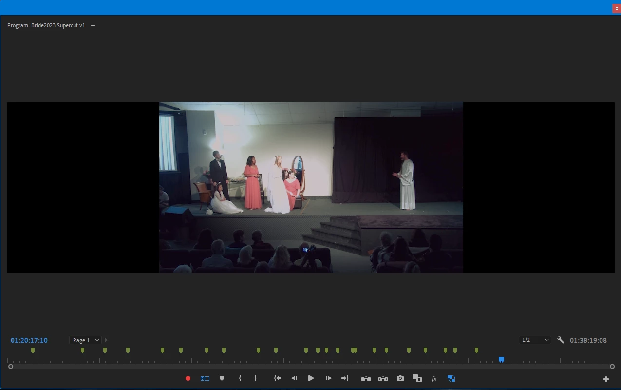

This is almost certainly a technical bug rather than user error.  I am using version 23.5.0 (Build 56) on Windows 10, and cannot get the multicam UI to appear for more than a second.  My Program window gets wide when I enable multi-cam as though it were intending to show my program alongside the multiviewer, but ultimately it doesn't show up.  Fiddling with certain things, like enabling/disabling Mercury Transmit, switching a camera, or toggling the track targeting on/off will sometimes display it for a second, before going right back to not showing it as soon as I click any other UI element.
I know what you may be thinking - it's a common for this to happen when the track with the multicam sequence isn't targeted, but as you'll see in the screenshot below, that's not the issue here.  I sincerely hope this bug can be resolved, since it is severely affecting my professional workflow.
To reproduce this bug, all you need to do is attempt to switch on the multi-camera view with your program monitor.  This has now happened across multiple projects with different footage.

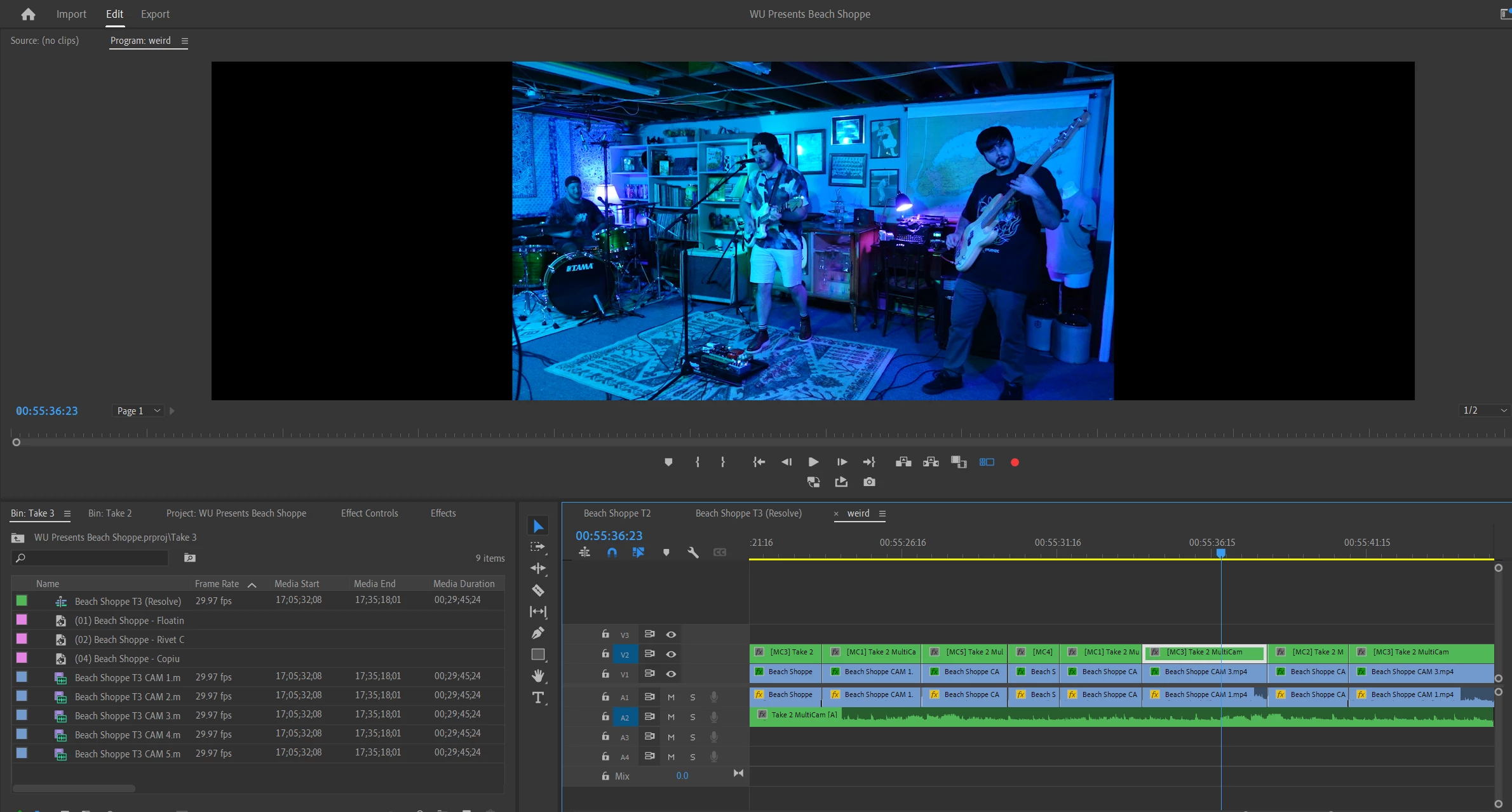

MyerPj
July 24, 2023
OK, I attempted to switch on the Multi-camera view per your instructions, and I even turned off all track targeting. Win11, PP 23.5
