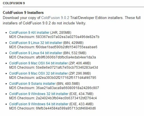

After downloading CF 9 installer, did you compare the checksum of the installer? http://www.adobe.com/support/coldfusion/downloads_updates.html#cf9

Yes, I checked the check sum.
