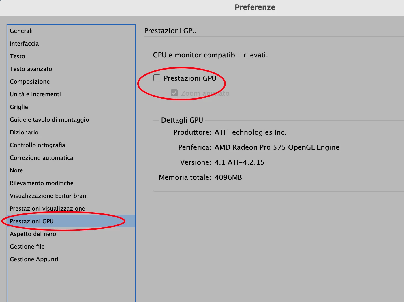

Turn off the GPU performance
Go to the InDesign Preferences
greenstreet35
June 16, 2021
Working just fine when unchecking the GPU-box as suggested 👍
