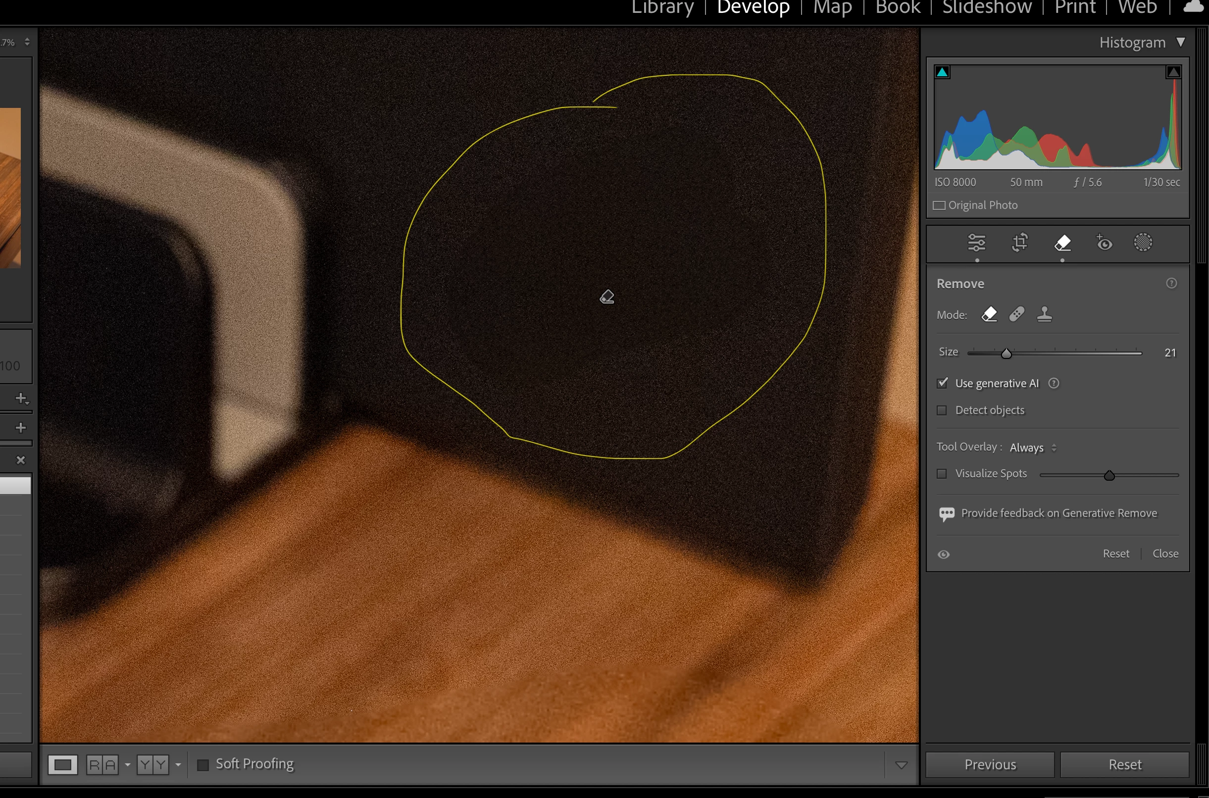

I would love there to be a soften edge option for instances where the background is a solid color. The way the tool is now, it creates a noticable line where it erased.

@erica60735567: "I would love there to be a soften edge option for instances where the background is a solid color."
I agree -- many have observed here that the replacements made by Generative Remove sometimes don't match the photo's tone or noise. To get better matches, these techniques sometimes help:
1. Adobe recommends applying Denoise before Remove. This can reduce the noise, making it more likely the replacement will match.
2. The replacement patch supplied by Adobe Firefly has a maximum size of 2048 x 2048 pixels. If the selected area in the photo is larger than that, then the replacement patch gets upscaled (and blurry). Try removing smaller selections if possible.
3. Conversely, try making a larger selection, even including the entire background. Upscaling of the replacement sometimes won't be noticeable then.
4. Sometimes there's a distinctly visible boundary where the tone or noise don't match. You can often use the heal tool around the boundary to get better feathering and make it less noticeable -- apply Heal in small brush strokes. Or use a Brush mask with maximum feathering, dropping local Texture, Clarity, and Sharpness to their minimum values. Sometimes, making a very raggedy selection around the object makes the boundary less noticeable.
5. For grain/noise in particular, see this post for how to ameliorate the problem by adding the grain back or reducing the grain:
https://community.adobe.com/t5/lightroom-classic-discussions/p-generative-remove-feedback-lr-classic-amp-lr-eco/m-p/14917497#M382464

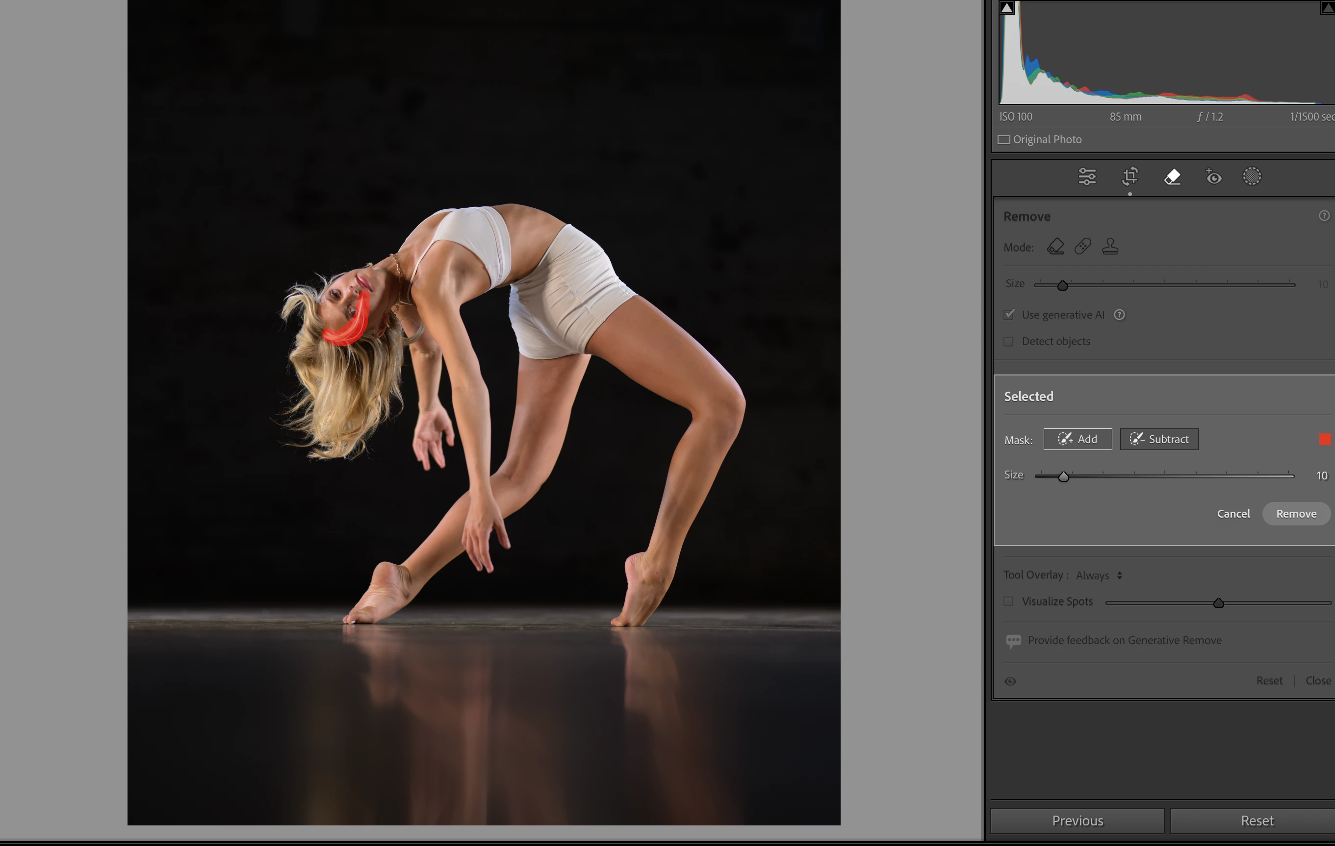

Aug 3, 2025 3:26 PM UTC
In general (in Lightroom with every version of generative AI remove) I have noticed generative AI has trouble recognizing people/faces when they are not in a normal, upright standing/sitting position. I work with dancers, gymnasts and acrobats and they are often in poses that are not typical for a person. After all that's the whole point of their sports. What is very easy for a human to see and understand, for example a person bend backwards, both the AI masks and the AI generative remove/fill fail.
I'm running into this problem on a daily basis. Here is just one example. The dancer does an extreme backbend with the face on the ground. I'm trying to fix the wrikled forehead. AI remove 'sees' the face, but doesn't understand it's upside down. It adds a mouth to where it would be if it was upright. I have regenerated many times. It always adds some version of a mouth. Rotating the photo 180 degree does not help. The system seems to have the original orientation info and seems to use that.
johnrellis
Aug 3, 2025 4:17 PM UTC
[This post contains formatting and embedded images that don't appear in email. View the post in your Web browser.]
That is creepy!
In this case, it looks like Remove is trying to match the shadow and reflection of the forehead on the shiny floor. When I select that as well, it does a better job in the first several variations:
Aug 3, 2025 5:29 PM UTC
Sometimes there is a way to do it, sometimes with just the healing brush. As I said, it's just an example of a more general issue I am dealing with on a daily basis. The AI is often failing to recognize peaople and their features if they are in 'unnatural' poses like the athletes I work with.

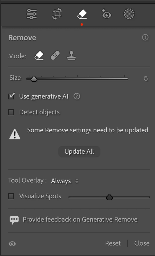

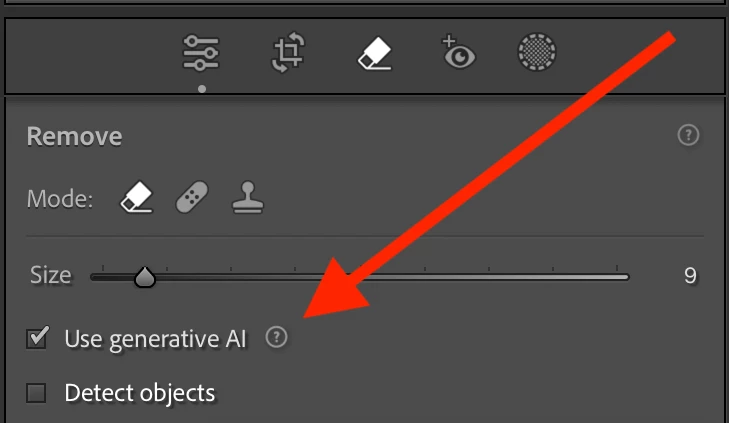

Aug 1, 2025 2:10 PM UTC
Aug 1, 2025 5:13 PM UTC
Go to Settings -> Update AI settings
Or use
[Option] + [Command] + U
Or click on the little yellow circular arrors at the top right
