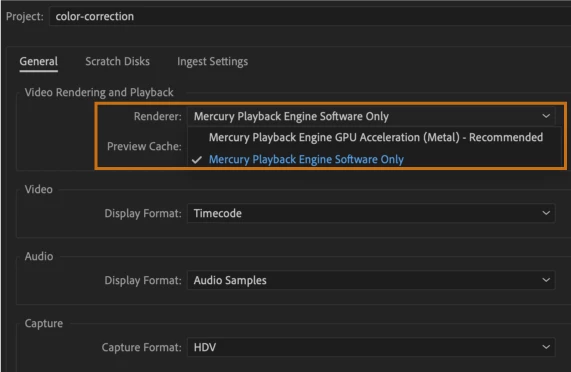

  • Change to the Software Only Renderer: If the issue persists, change the renderer of the Mercury Playback Engine to Software Only.
    1. Choose File > Project Settings > General. The Project Settings dialog box opens.
    2. Choose Renderer > Mercury Playback Engine Software Only in the Video Rendering and Playback section.
Note:
Enabling the Mercury Playback Engine Software Only option slows down the rendering speed considerably.
