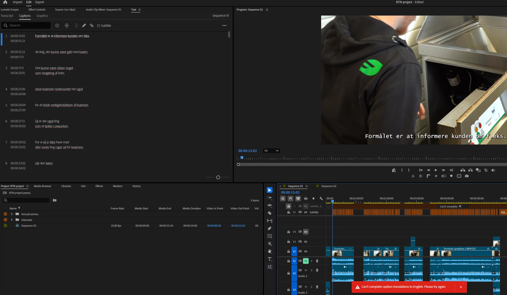

I've been translating subtitles with the new tools for a couple weeks now and everything was working fine, it worked on the beta version and now on the latest build (25.2.1) but now all of a sudden premiere shows the following error message whenever I try to translate. Even tried on a project that had been previously
translated without an issue, I went back and deleted the previous translations, tried to translate again and it's not working anymore.
Has anyone else encountered this bug or know s of a way to fix it?

Has anybody found out a solution for this? I´m getting the same error as soon as it hits 70%  “ Can't complete caption translations to English”

Translating captions to any language fails at 50%. We've tried exporting to .srt file, trying in batches, updating to the beta version 25.6 (currently using 25.5 in production) This is across users, projects and systems, all runnning Windows 11 23H2 build 22631.6060. Problem started roughly 2 weeks ago.
Steps to reproduce: highlight your captions in the timeline, either click translate captions from the text window or the subtitle track.
Expected result: See a new subtitle track with the translated captions.
Actual result: A red box error message "Can't complete caption translations to Dutch. Please try again"
Premiere Pro version: 25.5 and beta 25.6
OS version: Windows 11 23H2 build 22631.6060
GPU info: Nvidia tesla M10, driver version 572.83
