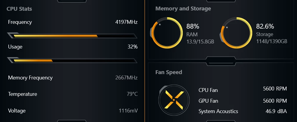

hello people, i have the ASUS TUF F15 with the following specs:-
Intel(R) Core(TM) i5-10300H CPU @ 2.50GHz 2.50 GHz
nvidia 1650ti
16gigs ram
512gb ssd
1tb hdd
i use hdd for editing videos. I often face problems like laggy preview and the the whole laptop just lags. Sometimes premiere pro just crashes and i lose all my unsaved work. I havent been able to figure out the problem yet. Its almost a year now since i brought this laptop. It had 8gigs ram but then i got it extended to 16. Still premiere pro doesnt work well. I have already selected CUDA and also gave 13gb of ram to premiere pro. My graphics driver is also up to date.
Is the product having an issue?
It would be cool if i get some assistance asap coz the warranty of the laptop is about to end and if there is a system error or fault, i could get it done.
