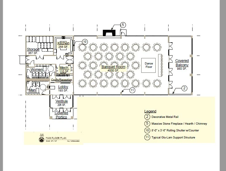

All pdfs created have yellow backgrounds
Every pdf I create - from a Word document or create blank page - has a yellow background. I have uninstalled and reinstalled and it hasn't fixed it. Version 2021.007.20091.
When opened in another program, they are normal white, so the problem is viewing/display.
