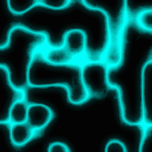

leather.bird: Is this close to what you mean by "keep Fractal Noise sliding upward forever"?
