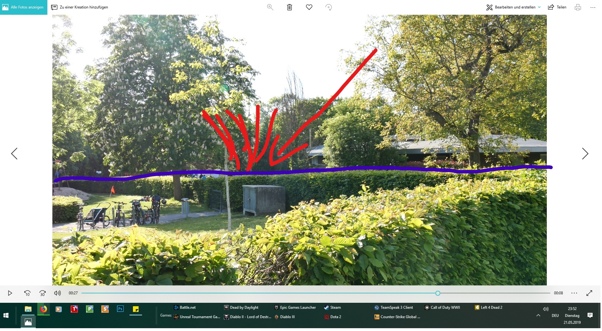

Thanks a lot guys for your quick help! I tried to find a way but unfortunatley its not that easy...
I might need a little more advices to get along with this -.-
I am really looking forward to make that scene pretty good, but its quiet hard for me. I added a photo below.
The blue line is the border for the foreground. The red arrow shows where the explosion should take place. The rest of the background should be behind the fire, smoke etc.
If you could give me a name for the technique I also can read by myself and you dont have to waste a lot of your time. I am looking forward for your help guys AE.jpg

If the shot is locked-off and there is little or no wind you can probably export a frame to Photoshop and create a matte by selecting the sky, then doing a fair amount of painting on the layer mask.
If it is windy or the camera is moving you'll be better off finding a better location.

Hi. The general term for what you want to do is "Compositing". There are a lot of  techniques that you need to learn, including;
Camera Tracking (to keep your explosion/smoke etc in the right place when your camera moves)
Rotoscoping (cutting out the things that are in front of your explosion so they stay in front)
Color Correction (so your explosion looks believable in the scene).
Action Essentials comes with 4 tutorials which you should view, perhaps they will give you a good starting point?
