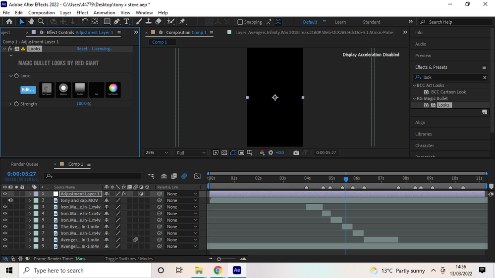

Hiya, I'm new here and I've been struggling with this problem for a while now. I have the 2022 version of ae and I use the Red Giant Magic Bullet Suite 14.0.2. But when I add the MBL plugin to my adjustment layer there is always an error. And I've never managed to get it to work. I have my clip and it looks completely fine, but I add the plugin and either it just doesn't appear and just makes the screen go black, speeds the whole video up really fast, keeps my cedit but leaves it unchanged, or makes the screen go black and adds random flashes.
For the attachments below:
1. So I have my video which is working completely fine.
2. I add the plugin and my video turns black.
3. I select edit and I'm able to see the video again, I select a colouring and then press the tick in the bottom right.
4. my video goes back to being black and when I watch the preview it has random flashes.

I contacted the support team and the said that I didn't have enough dedicated video memory per monitor meaning by GPU didn't have enough room as a result. They said the only solution was moving to a device which has a graphics card with more VRAM.
Traducir

Without any system info this doesn't go anywhere. Since MBL  is heavily reliant on hardware acceleration on top of AE's own stuff, the most likely cause is simply compatibility issues with your GPU or an incomaptible driver. that would be the first thing to check. Anything beyond that requires more info.
Mylenium
