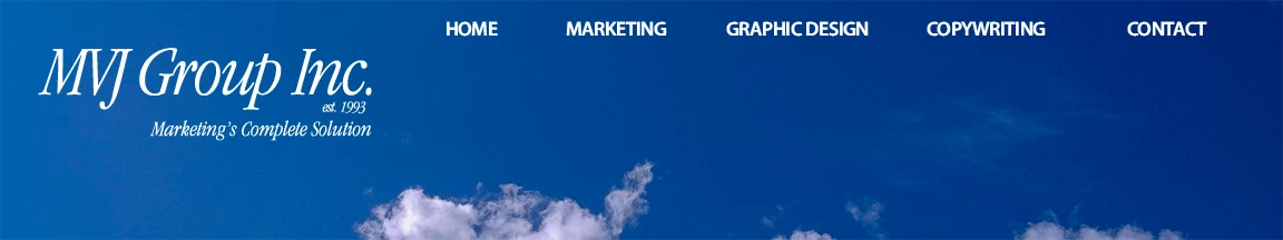

My header has a background image (1200px by 225 px) -- not a page background image. How do I place the logo and the navigation bar on the image, not above it? I have tried everything and searched everywhere. Logically, you would think you could change the color that coding expects to an image, but you can't -- or I couldn't. It must be a coding problem that I haven't figured out. I did it in Muse, but I can't in Dreamweaver. I want it to look like this.
Can you please help me?
Thank you,
Margaret

    Thank you Jon. I went to the link you provided and they said it was for a full page, although when I went further down the page and it said "The background image can also be set for specific elements, like the <p> element:" I wish they had gone further and had given a code example of the "header" element -- that is of course if it is an element. It must be possible, because I have seen others do it, but maybe that's because they weren't using Dreamweaver. I can't believe it's not possible in Dreamweaver.

    Thank you for your response, but I am not the best at Dreamweaver (I’m re-learning it.), so I may be misinterpreting what you are saying. Is the parent container the whole page? I don’t want the whole page. I have tried the background for the container for the header, but I hasn’t worked. It doesn’t seem to understand what I’m coding. I’m not the best coder either. I really did like Muse. But I must relearn Dreamweaver and the basics are the hardest.
