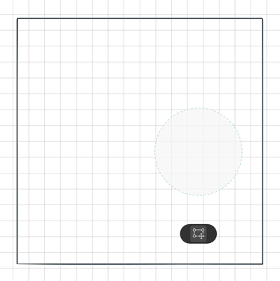

i'm facing same issue with drawing aid not able to re-size. The stencil edit button shows but doesn't do anything on clicking. Button shows as if it is on edit mode but the editor points on the stencil/drawing aid don't show up for re-sizing.

Hello everyone, here is my problem in Fresco: the edit button of the circle tool doesn’t work anymore. It is impossible for me to adjust the size and shape of the circle. I uninstalled and reinstalled Fresco, without success. In advance, thank you for your help.

Tap the tool icon at the bottom of the stencil to toggle between drawing mode and stencil edit mode (size and position).

Thank you Michael, but I use this tool regularly. But the icon no longer reacts when clicked on, whether with the stylus or with the mouse. But I thank you for your response, have a good day.

As you can see, my equipment is not on top, but everything was working perfectly. And only this tool no longer works.I can trace, but no longer set the size correctly, and the small stencil editing button no longer reacts to the stylus or mouse.

When I turn on drawing aids whatever mode it is in, it is 'stuck' in that mode - with handles or stencil mode. But if I try the following a few times I can eventually get the mode I need:
1. turn on drawing aid - can't change mode
2. change brush (vector to pixel or eraser for example)
3. turn drawing aid off and on again....sometimes you'll get handles back sometime not so repeat 1-3 until it works
4. But then you can't change handle mode to stencil. So need to repeat the process until i get it how you need.

After watching your video and trying again on my Windows machine, I have been able to duplicate this erratic behavior, after clicking in and out of the stencil tools several times. Sometimes it works as expected, sometimes the UI is incorrect but the stencil works, and sometimes it just plain does not work.
As a workaround I found that changing from the circle stencil to the square stencil and back returned the functionality.
