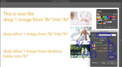

sorry, my english not good. I will do more testing on this weekend. i just test place image form menu bar is no color change problem, but drop images into Illustrator from "Br" or desktop folder will change all object color & "swatch" color (color name will not change) . if u set the color is color type "Global", "Global" color will not change. pls see my attached images~~THX!!

i find image very low-res, i share image again!!

I testing on this weekend that there is no problem in drop and drop images into ai file in CMKY mode, only RGB mode will change all object color & "swatch" color except set to "Global" color on "swatch". Place image into ai file from menu bar > File > Place is no problem!!
It’s so funny that every time you drop a image into ai file, the "R color" number and the "G color" number of the RGB color will be reduced by one, but the "B color" number will remain unchanged. hahaha!!

WOO! i just testing again for "drag and drop images into ai" in CMYK mode also will change color.........!!
Fortunately, I have temporarily found a way to continue using the "drag and drop images into Illustrator" method. i need to select the warning in the "color setting" dialog box. Each time you drag the image into ai file, a different color profile image will be pop up warning box. As long as you choose not to convert the color file, that's all!!

@rickyy10263297 Do you drag and drop images into Illustrator?

very very very thank you, just testing for "drag and drop images into Illustrator"! got it ! got it!! this is problem!!
Jun 21, 2024 Jun 21, 2024
Thanks @rickyy10263297  Drag and drop has been mentioned a couple of times as the cause of changing values.
I cannot replicate that, but I can replicate the change of appearance and document color profile after draging from Photoshop, that may be a different but related bug.
@Srishti Bali Can someone from the Illustrator team contact Ricky? It seems like this problem is hard to replicate, but Ricky can.
