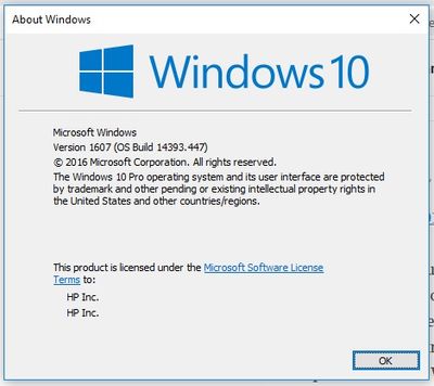

Community Beginner ,
Sep 07, 2021 Sep 07, 2021
Thank you Anshul. Here is my windows version:

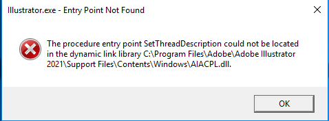

New Here ,
Sep 09, 2021 Sep 09, 2021
Adobe Employee ,
Hi @JebodiahAngusMcCoy,
Thank you for sharing the screenshot of the error. Could you please also share the screenshot of the Windows version and Build no. as asked above by me.
To check your Windows version and build number, you may open the Run Dialog box by pressing Win+R, type "winver," and press enter.
Anshul Saini

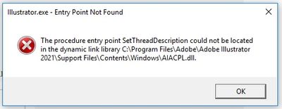

Hi Anshul,
I am having the same issue. Please please help! I have spent the past 3 days trying to sort this issue out and I still can't get fixed. Even when I try to unistall the latest version and then reinstall the older version it's still not working. The older version will open up and you think it will work but than it crashes when I try to open up any of my illustrator files. I have attached a screen shot of both my Windows version and the error message that I am getting.
Thanks in advance. I pateiently await your reply.

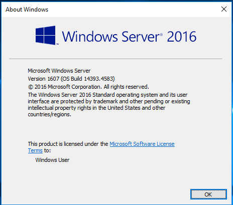

Sep 10, 2021 Sep 10, 2021
Running Illustrator on Server 2016 as a Remote Terminal Server and getting the same problem as everyone else even after a reinstall. Didn't do the Adobe Cleaner because if it's not guaranteed to work I don't want to remove every Adobe product for all of my Remote Users simultaneouly.
Adobe Employee ,
Thank you for sharing the screenshots @michaelwigle@Candace5E71@RZhasan. I checked, and you all need to upgrade your Windows OS as Illustrator is not supported on the following versions:
  • 1507
  • 1511
  • 1607
  • 1703
  • 1709
  • 1803
After updating the Windows OS, perform the steps suggested on the CC Cleaner Tool help article, uninstall the Illustrator, and reinstall it from the Creative Cloud Desktop app.
Anshul Saini
New Here ,
Sep 11, 2021 Sep 11, 2021
This isn't a solution though is it. Anyone using Windows Server 2016 can't update beyond 1607 without replacing their operating system.
