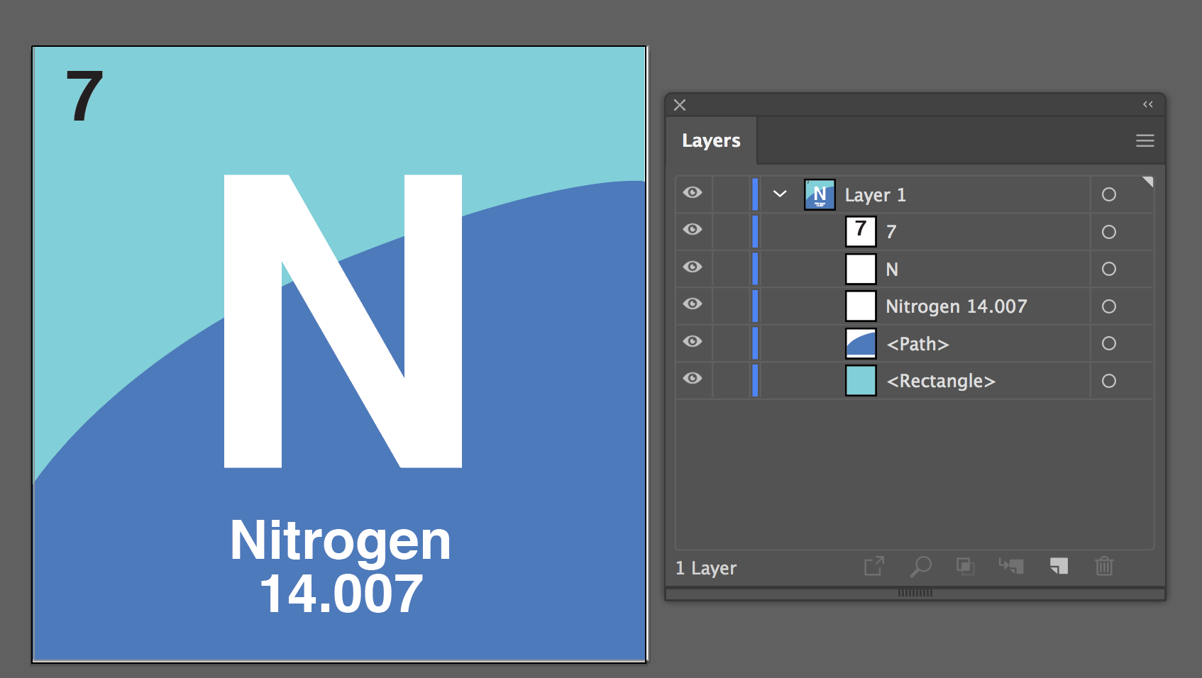

From what I can see, you have only one Layer. What you see listed under it are not Sublayers, but individual elements of your design. It looks like each letter has been separated out, and further had its interior section separated.
When I recreate your art, I get a much more compact layers panel.

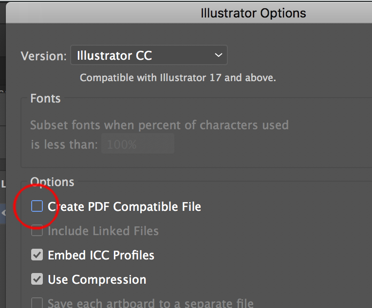

A few things you should do on Illustrator files:
File >> Save as and turn OFF PDF compatible. This usually makes the .ai file size much much smaller,. depending on the content. The default of ON, so many people miss this important step. PDF compatible only needed if you drop into InDesign or After Effects.

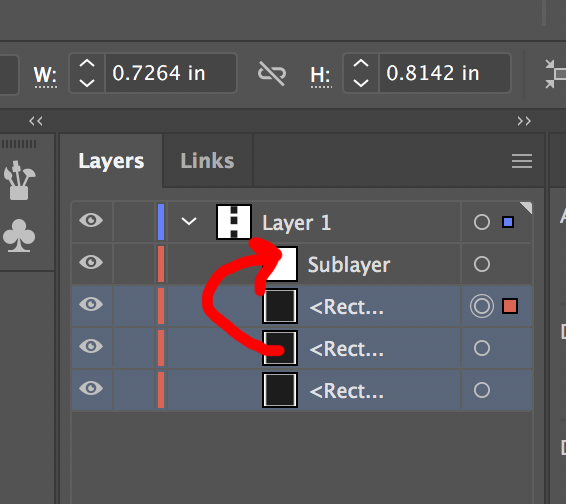

1) Make a new sublayer
2) Select first object, hold down shift select last item. Drag into sublayer
3) Final Result
My expertise in everything but sublayers in Illustrator as I avoid them and the issues they cause, so maybe someone else can expand upon these < > and what exactly they mean. To me by default they are on most objects and not on layers or sublayers. You can manually remove them, but not sure if they serve any purpose.
Hi Mike,
Here’s one reason:
Let’s say you have a couple or ten layers and you decide you want a layer clipping mask. At the end of the project, you create a new layer at the top and drag & drop the other layers to become sublayers. Then you draw a rectangle on the top layer, select that top layer, and make a layer clipping mask from the panel menu.
Here’s another: you want to collect like items, but you don’t want them group because you need to select them individually. You collect them into a sublayer as I showed in an earlier post.
~ Jane
