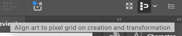

Solved:
If it is still not doing it after this, I think its a bug in your file so you will have to make a new one and copy things across. It only worked for me then.
View > Pixel Preview
View > Snap to pixel
‘Align art to pixel grid’ Icon, the arrow to the right - check advanced settings
Make sure art aligns to pixel grid or it will add another pixel to compensate

https://www.youtube.com/watch?v=NAHkCEp3-Wg&t=117sScreenshot 2025-01-21 at 14.20.28.pngScreenshot 2025-01-21 at 14.20.09.pngScreenshot 2025-01-21 at 14.20.38.pngScreenshot 2025-01-21 at 14.20.46.pngScreenshot 2025-01-21 at 14.20.53.pngScreenshot 2025-01-21 at 14.20.59.png
