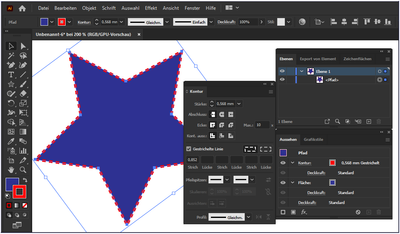

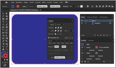

I gave you a partial solution to the outline (no scripting) that doesn't take any time - once the graphic style has been created. We don't know anything about your project. I am so sorry this was not acceptable to you!
Here is a script snippet that does the same - it creates a dashed stroke for the selected path item:
// pathItem_dashed_Stroke.jsx
// select one pathItem before running this script snippet
// regards pixxxelschubser
var aDoc = app.activeDocument;
var aSel = aDoc.selection[0];
aSel.stroked = true;
// swatch with name "CMYK Magenta" should already exists in your document
aSel.strokeColor = aDoc.swatches.getByName("CMYK Magenta").color;
aSel.strokeDashes = [2.8346457];
aSel.strokeWidth = 2.8346457;
There is no error management and you should build it into the other script yourself.

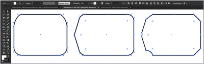

Guide ,
Nov 22, 2020 Nov 22, 2020
Is this the radius we're talking about?  If so, it would seem that this is easy to calculate.
Explorer ,
Yes!!! Exactly
Hi @femkeblanco
please identify the roundness and if so the radius of each corner.
Guide ,
Hi @pixxxelschubser.  I take your point about roundness.  But since we seem to be talking about a "radius", I presume we are talking about a (all symmetric) circle with a (single) radius.

// select round-cornered rectangle
var points = app.selection[0].pathPoints;
var x1 = points[4].anchor[0], x2 = points[5].anchor[0];
var y1 = points[4].anchor[1], y2 = points[5].anchor[1];
var rect1 = app.activeDocument.pathItems.rectangle(y1 + 20, x2 - 30, 20, 20);
var text2 = app.activeDocument.textFrames.areaText(rect1);
text2.contents = Math.abs(x1 - x2);
Note that this has to be a truly round-cornered rectangle and not an effect.  An effect is an appearance attribute, i.e. the rectangle appears to be round-cornered, but is not truly so.  If you used an effect, you need to expand the appearance first (Object > Expand Appearance).
