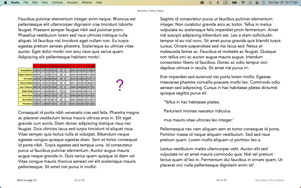

alignment of table
Enthusiast ,
Dec 17, 2022 Dec 17, 2022
There is a table in Id.
I exported it to EPUB.
The table looks OK on iPhone (Books app).
There is an alignment issue on Mac (Books app).
Do you have any comment on it?

Most ePub creators suggest that in a Reflowable ePub you should use an image for tables.
Community Expert , Dec 18, 2022 Dec 18, 2022
Have a look at Object Export Options.
Community Expert , Dec 19, 2022 Dec 19, 2022
Using an image is a last-ditch option for tables with a layout too fussy or complex to let an e-book reader manage, like this —
Most simple, linear tables (like the OP's) can be exported successfully. The trick is to focus on the actual exported table and not the one in the ID doc; this is one of those cases where a somewhat "distorted" layout is needed to lead the reader to a clean presentation. (The faults lie mostly in ID's refusal to export HTML padding, so you either have to reformat at

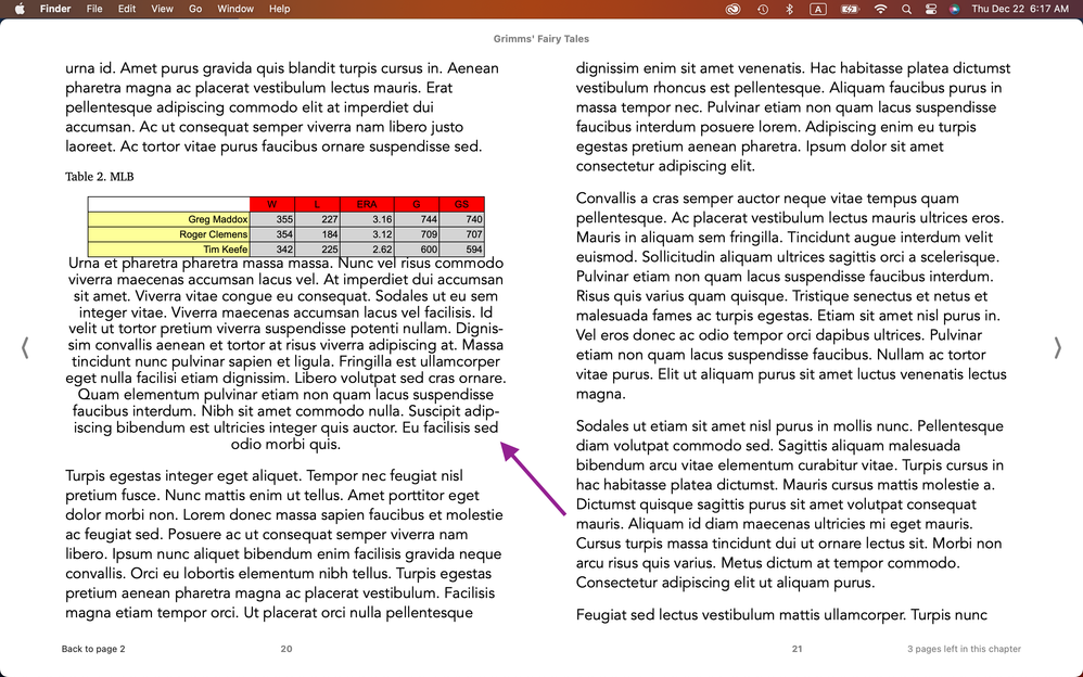

STEP 1. There are no text frames.
STEP 2. I placed the table in the middle (width: 90%). There was an issue; the following paragraph is wrongly formatted.
So,
STEP 3. I applied Body Paragraph 2 to the table to keep it in the middle.
STEP 4. I applied Body Paragraph to the following paragraph. The issue is; the table is aligned to the left.
STEP 5. I applied Body Paragraph 2 to the table.
STEP 6. The issue is; the following paragraph is also under Body Paragraph 2.
I was expecting:
the table to Body Paragraph 2
the following paragraph to Body Paragraph.
Why do the table and the following paragraph fall into the same paragraph style?

Tables will attach in different ways to adjacent paragraphs, including just "running on" from prior paragraph text or into following text. You want to make sure they are on a paragraph of their own:
[Paragraph in BODY style]¶
[Paragraph in centered style, holding Table]¶
[Paragraph in BODY or some other style]¶
That is, with hidden characters on, you should see a pilcrow at the end of each of these three paragraphs, the table included.

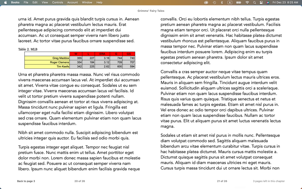

This is what I see now.

Apply whatever style you want or need to each of those three elements. They should be completely independent with the connection between the table and the following paragraph broken by the paragraph return.
I assume you want the regular body style on the last paragraph; apply it, and it should leave the table (and its paragraph) centered. That formatting should all export to EPUB without needing any CSS changes other than the width: statement.

Starting from the black and no/zero border didn't work.
The white and 0.001pt border worked.
I got what I wanted.
Thank you very much for your help.

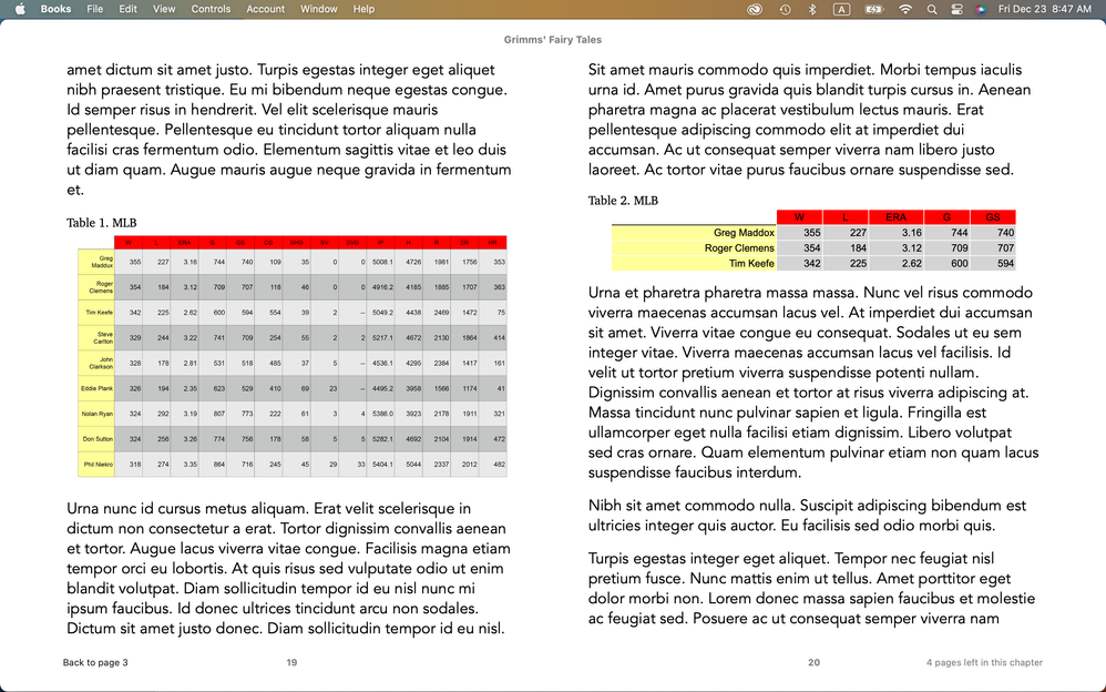

I changed the class name in Paragraph Style Options.
It looks OK.

Tables are one of the areas where a small amount of CSS goes a long, long ways in allowing you to control appearance, positioning, cell format, etc. It's a little bit tricky and non-intuitive; you have to blend an ID understanding of tables with an HTML/CSS understanding.
But, for example, these three tables:
JamesGiffordNitroPress_0-1671817830253.pngJamesGiffordNitroPress_1-1671817848472.pngJamesGiffordNitroPress_2-1671817869880.png
...are all the exact same export from InDesign, with adapted CSS.
You can do a lot with ID styling, if you're willing to experiment and "try again." But if you're going to get into CSS at all for EPUB, this is a great place to start.

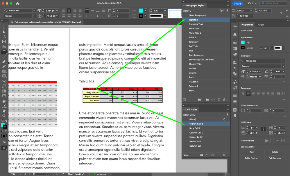

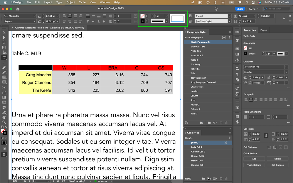

Step 1. For some test, I made a change to the table on Id.
Step 2. I created cell style for the top-left cell (topleft Cell 2).
Steps 3-5. I wrote css.
Step 6. On EPUB, I still see a white gap at the corner in the top-left cell.
Am I following you?

It's kind of like stacking tiles; you have to get all the commands in the right order. You may have to create four cell styles there (blank, red, yellow, gray) and be sure the black borders are defined in each.
There are also more sophisticated table commands that control table layout in more sophisticated, indirect ways, such as empty-cells, the collapse arguments, and more. Just as this is a good place to use CSS, a full command of all these infrequently-used CSS table statements is an asset.
