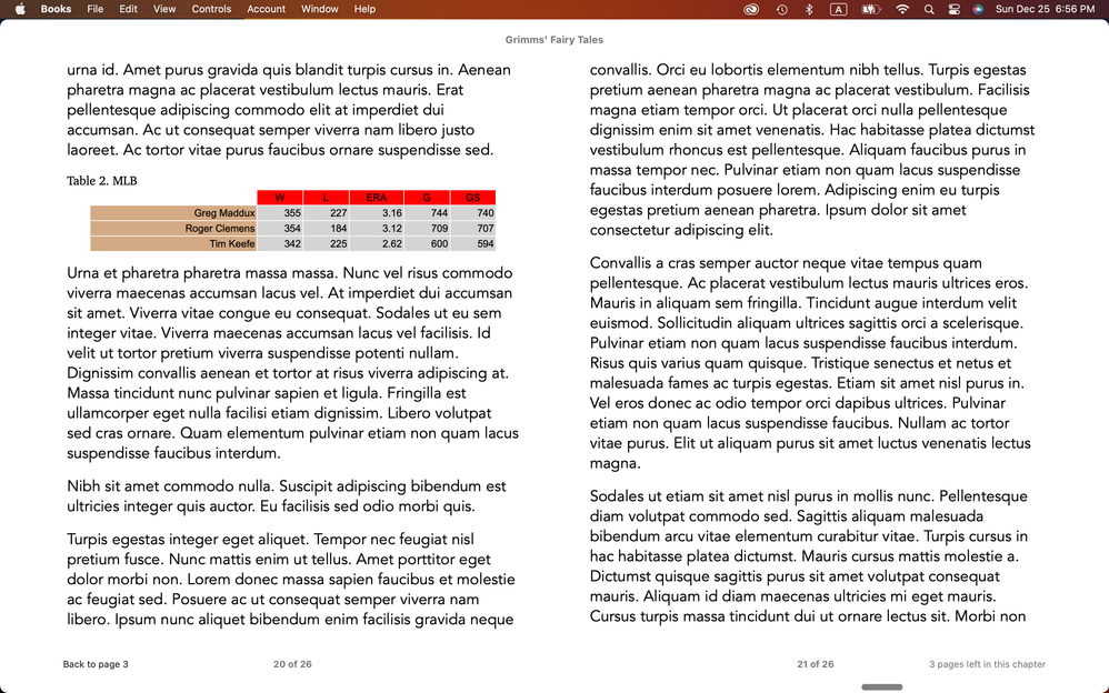

alignment of table
Enthusiast ,
Dec 17, 2022 Dec 17, 2022
There is a table in Id.
I exported it to EPUB.
The table looks OK on iPhone (Books app).
There is an alignment issue on Mac (Books app).
Do you have any comment on it?
Hosun
IdIdBooks app (iPhone)Books app (iPhone)Books app (Mac)Books app (Mac)

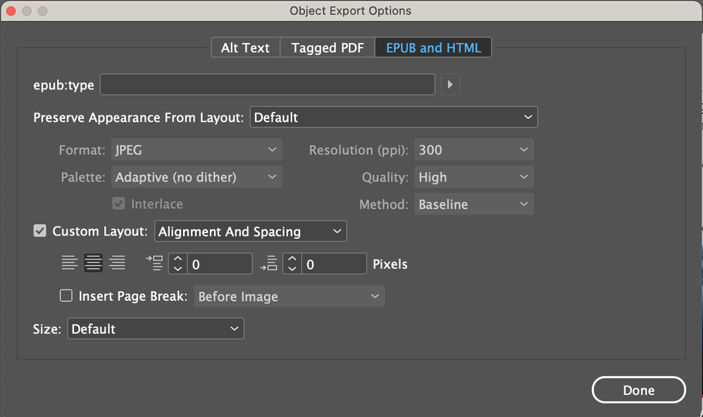

Have a look at Object Export Options.

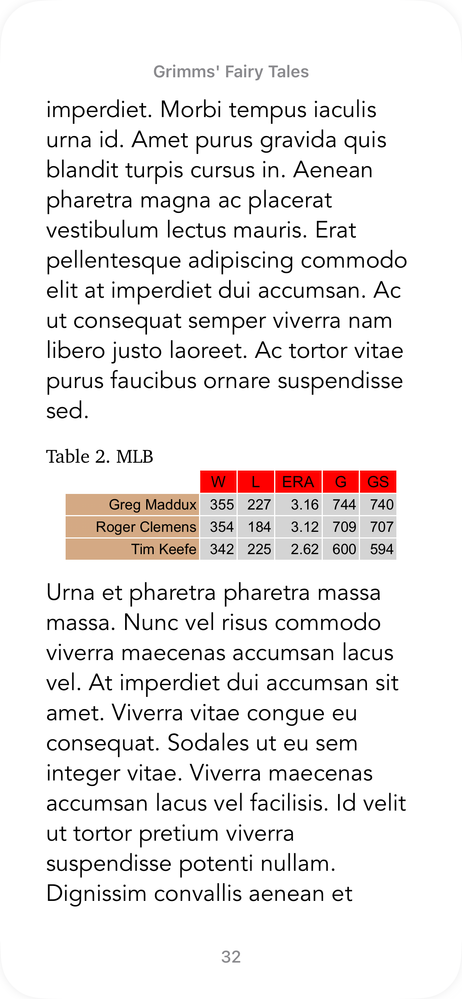

Enthusiast ,
Dec 25, 2022 Dec 25, 2022
Step 1. I gave 3px and black to the borders of Greg Maddux.
Step 2. The topleft corner of the cell is a clean-cut.
Step 3. I gave 0px and white to all the borders of the table. (border-collapse:separate, border-spacing:1px)
Step 4. It looks better than black border.
Hosun
Step 1Step 1Step 2Step 2Step 3Step 3Step 4-1. Books app (Mac)Step 4-1. Books app (Mac)Step 4-2 Books app (iPhone)Step 4-2 Books app (iPhone)
Enthusiast ,
Dec 27, 2022 Dec 27, 2022
Screenshot 1 (Table 2). I took out caption and table from the text boxes and place them in the text flow to make the live text.
Screenshot 2 (Photo 4). I took out caption. Which one would I choose in Size of the Object Export Options? (in keeping consistency of Table 2 and Photo 4)
Hosun
Screenshot 1 (Table 2)Screenshot 1 (Table 2)Screenshot 2 (Photo 4)Screenshot 2 (Photo 4)
Enthusiast ,
Dec 28, 2022 Dec 28, 2022
I tried options in Size.
Default and Relative to Text Flow keep consistency in Photo 4 and Table 2.
I see there is no difference between Default and Relative to Text Flow.
Am I correct?
Hosun
Size: DefaultSize: DefaultSize: Default (Books app on Mac)Size: Default (Books app on Mac)Size: Relative to Text FlowSize: Relative to Text FlowSize: Relative to Text Flow (Books app on Mac)Size: Relative to Text Flow (Books app on Mac)
