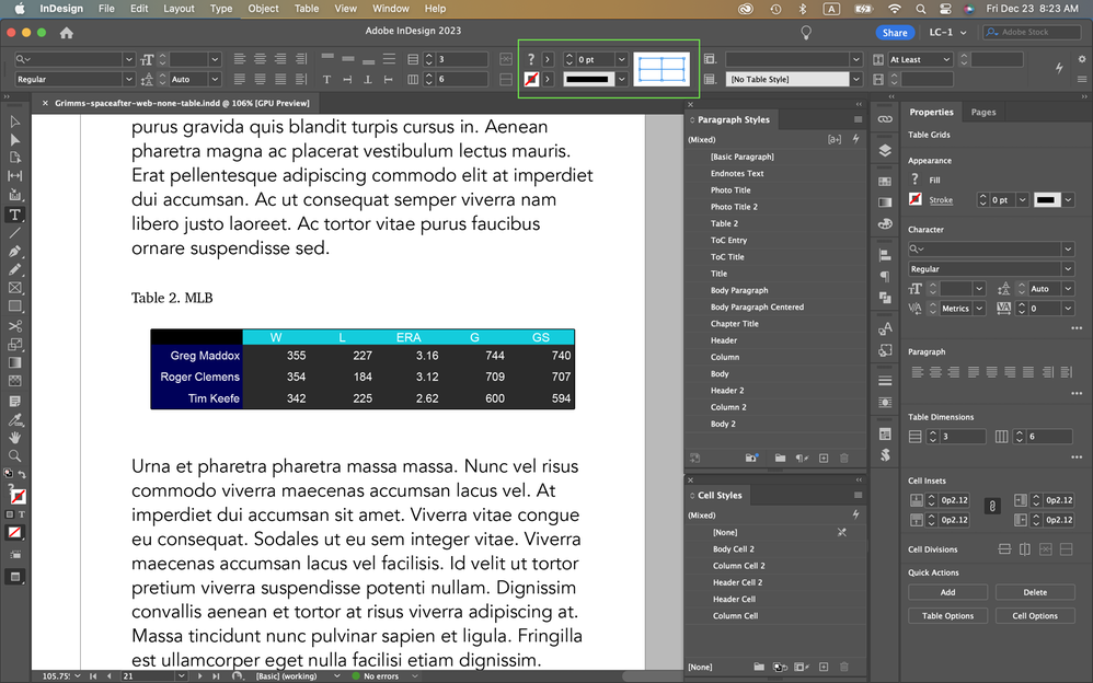

Enthousiaste ,
Dec 22, 2022 Dec 22, 2022
Looking at Table 2, there is only bottom border in the top-left corner cell on Id.
On EPUB, there are all 4 borders.
Can I place white rectangle on Id?
Hosun
Tables get tricky because table and cell styles overlap in a hierarchy that's not always predictable.
Try creating a cell style with a white background and "none" or 0 for borders. If that doesn't work, apply thin white borders. One or the other should produce that "missing" cell appearance.

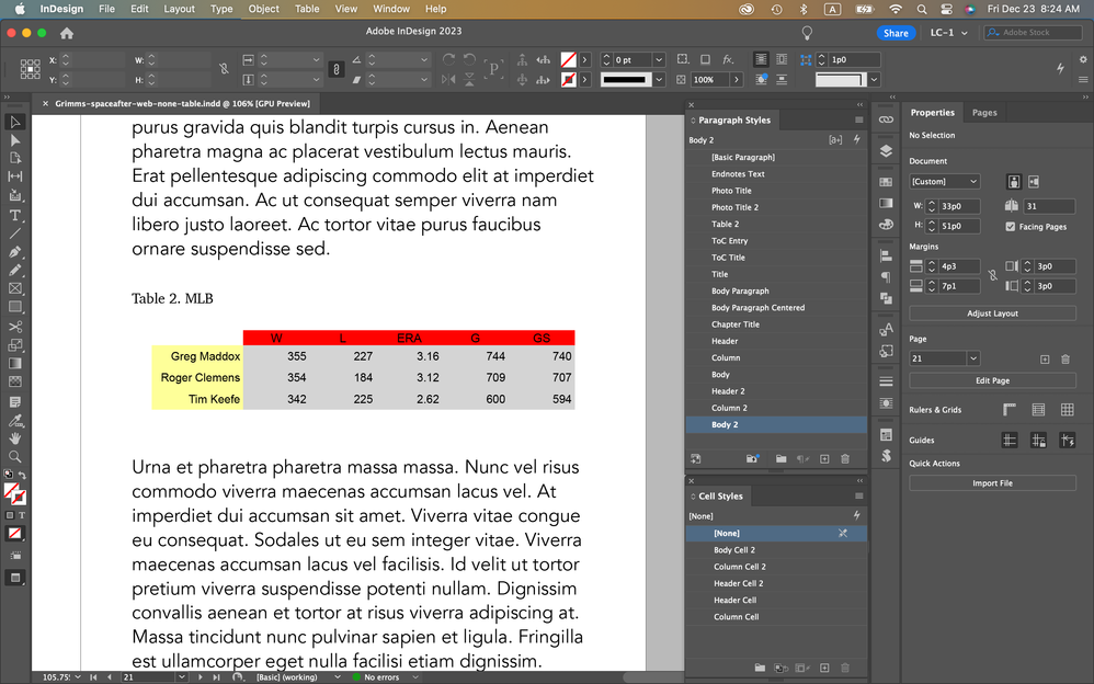

Enthousiaste ,
Starting from the black and no/zero border didn't work.
The white and 0.001pt border worked.
I got what I wanted.
Thank you very much for your help.
Hosun

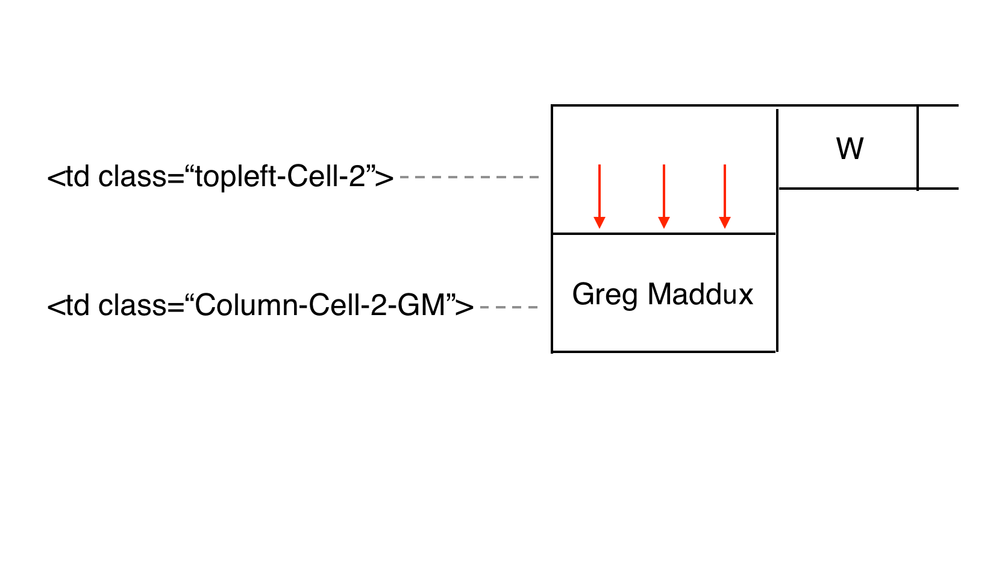

Enthousiaste ,
[SOLUTION 1 (Steps 1-3)]
Start from no border.
On EPUB, there are borders.
[SOLUTION 2 (Steps 4-9)]
Start from white and 0.001pt border.
black and 1pt bottom border to the top-left cell.
In my case, SOLUTION 1 doesn't work.
Only issue of SOLUTION 2 is the corner of the top-left cell. (White gap is hardly seen.)
Hosun

Enthousiaste ,
My previous reply is wrong.

Enthousiaste ,
Dec 23, 2022 Dec 23, 2022
Step 1. For some test, I made a change to the table on Id.
Step 2. I created cell style for the top-left cell (topleft Cell 2).
Steps 3-5. I wrote css.
Step 6. On EPUB, I still see a white gap at the corner in the top-left cell.
Am I following you?
Hosun

Enthousiaste ,
Dec 24, 2022 Dec 24, 2022
I think the problem is; <td class="topleft-Cell-2"> is above <td class="Column-Cell-2-GM">.
The top border of <td class="Column-Cell-2-GM"> is not visible.
I'd rather go with white border.
Hosun
6-Screenshot 2022-12-24 at 8.39.29 PM.pngScreenshot 2022-12-25 at 5.39.31 AM.png
I don't see a problem in the latter example, unless that is with the white border.
I can't find my detail notes on tables so I may just spend some of this long weekend messing around with a redo and some things I didn't evaluate before.
Something you might try is adding 'border-collapse: separate;' to your table definition, to see if that affects the various adjoining borders in a positive or negative way. I'm pretty sure 'collapse' is the default value for both ID export and EPUB interpretation; experiment with both.
