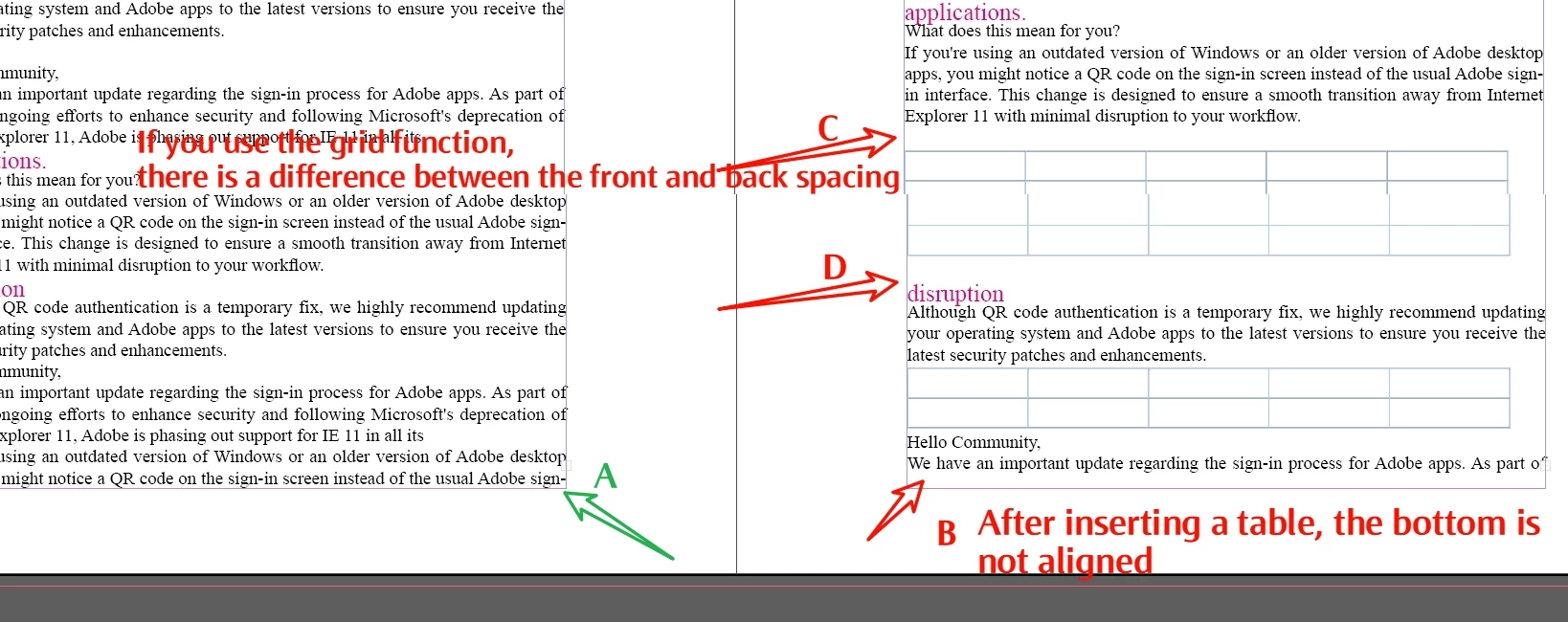

How do I ensure bottom alignment for documents with tables? Row alignment?
  • December 19, 2024
  • 1540 views
otice in the example I gave that
When there is no table:
The bottom of the left page is aligned.
When the table is inserted, the bottom of the right page is not aligned.
In the past I would adjust the line spacing before and after the table to roughly align, but with 100 tables I'm at a loss. And the client is always changing it around, making you go crazy a few firsts.
I tried the first row baseline, but it is difficult to achieve automatic alignment because of the variable number of tables and rows per page.
Finally I tried grid layout and the bottom automatically aligns.
But another problem comes, the table is fixed in the grid, you can't move him, sometimes the table before and after spacing is not the same, it's hard to see.
You can only adjust the row height, the space before and after the table.
Do you guys have a good solution, can you share it.
