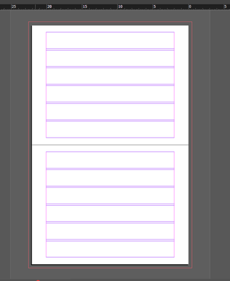

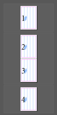

I am working on a book that needs to be in landscape and opens upwards, sort of like a calendar. Issue is the only way i can make my spread have 2 pages below each other is by setting my pages to a portrait orientation then rotating them 90 degrees CW which also rotates the columns, and it the pages will revert back to portrait when exporting.
 Any ideas how i could solve this?

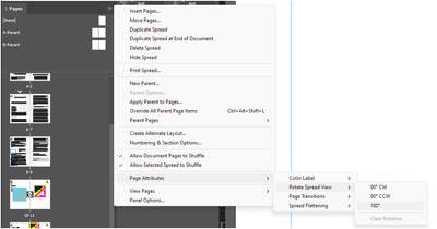

It's easier to do this if you rotate the spreads first. Here's steps I recommend.
Create the document with whatever settings you need including the number of pages.
Rotate the view of the parent pages and do whatever you need there including any text frames, page numbers, etc.
Choose all of the live pages and rotate the view there. You should be good to go.

Rotating spread view results in the columns being rotated along with it, and the printer is kind of a pain to deal with so I'd just rather have the file be perfect on the export.
For the sake of making this job easier, I ended up creating the file without turning facing pages on and manually moved two pages below one another then duplicated the spread however many times I needed.

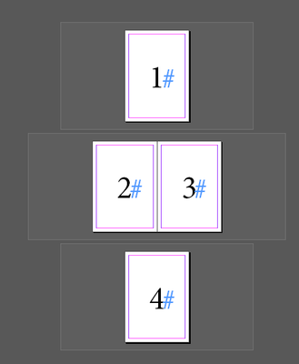

@jonofarc
It's possible - and quite easily achievable as you've done already - but just in case, steps for others:
Steps:

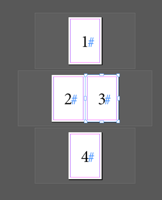

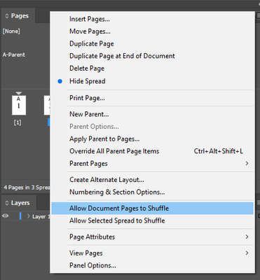

1) Turn off/uncheck Shuffle - for the document and all spreads,
For Spreads - you need to select all Pages first.

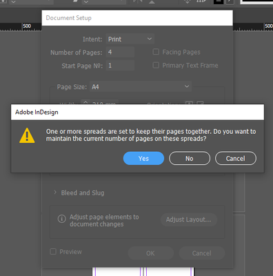

2) in the Document Setup - turn off Facing Pages - reply YES:

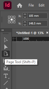

3) Switch to Page Tool:

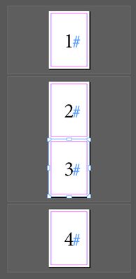

4) Now, you can Drag&Drop pages:
For small documents - it can be done manually - for larger - can be of course automated using a script.
Dec 19, 2024 Dec 19, 2024
As @BobLevine stated, rotate FIRST, then add content.
