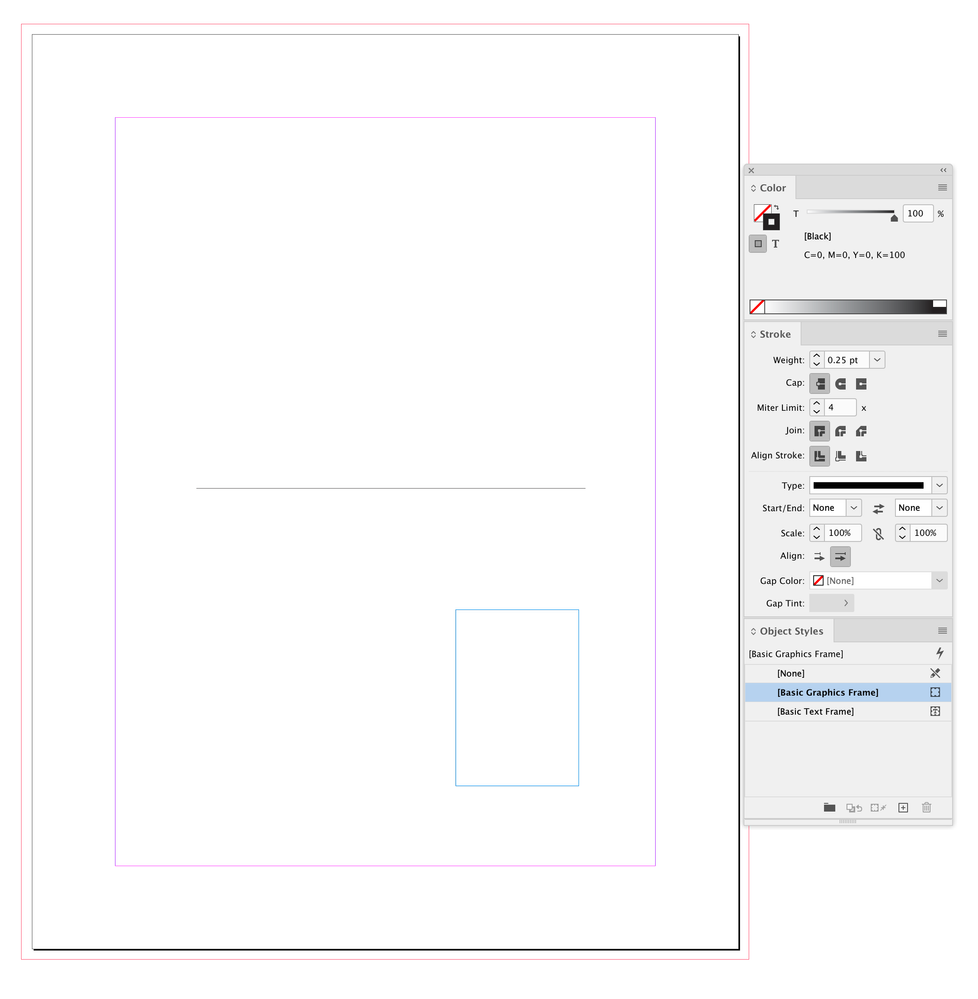

I see the problem, your default Object Style is set to [None], and the [None] OS can’t be edited—its stroke weight is set to 0. You would have to set the default Object Style to something else, then set your default stroke and fill.
The script for that would be this:
var os = app.objectStyles.itemByName("[Basic Graphics Frame]")
os.properties = {strokeWeight: .25, strokeColor:"Black", fillColor:"None"}
app.pageItemDefaults.properties = {appliedGraphicObjectStyle:os};
var d = app.documents;
if (d.length > 0) {
    for (var i = 0; i < d.length; i++){
        d[i].select(NothingEnum.NOTHING)
        d[i].pageItemDefaults.properties = {appliedGraphicObjectStyle:os};
Here’s a saved .jsx, which you can download and copy into your scripts folder:
https://shared-assets.adobe.com/link/3a42d3c5-57f2-4f5c-575b-42a7f6ad7370
Before and after running:
