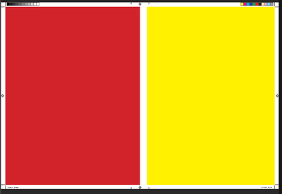

Is there a way to add a gap for bleed between 'Facing Pages'?
I don't want the bleed to appear on the opposite page (on my exported PDF). I would like to show the bleed as if the document was set up without facing pages. Sample attached: current bleed, facing pages, without facing pages.

Set up as facing pages, and in the Pages Panel flyout menu uncheck Allow Document Pages to Shuffle. You can then simply grab one page of any spread in the panel and drag it away from its partner until you see a vertical line.

Wow, How did you do this? "Use the Page Tool and separate the page on the X axis
This then shows the bleed for the page that's beside it"
I can't get it to have the gap (see attached)
November 3, 2022
In the Document Setup - Facing Pages has to be ticked off.
Allow pages to shuffle = off
Move page 3 up beside page 2
Page tool
MOve it across
IF you already have a document with Facing Pages
Turn off Facing PAges
Then repeat the above process.

You need to set your pages up like this
You can do this manually by dragging the page slightly to the side.
If you have lots of pages there's a script
https://creativepro.com/breaking-pages-apart-to-bleed-off-a-spine/

Hi @Friends10 , If the binding method uses folded and gathered signatures—e.g. saddle stitch, perfect binding—the inside bleed would be removed during the imposition at the folds, so its content doesn’t really matter.
If it’s something like wire-o where the inside page edges are exposed and trimmed, then you might setup the document as non facing pages, but with spreads—with Facing Pages unchecked the Pages tool can be used to separate the spread pages. See this thread:
https://community.adobe.com/t5/indesign-discussions/gutter-bleed-still-the-same/m-p/11367643#M198592
Keep in mind that with Facing Pages unchecked there is no spine so the Paragraph justification setting Align Toward Spine does not work.
