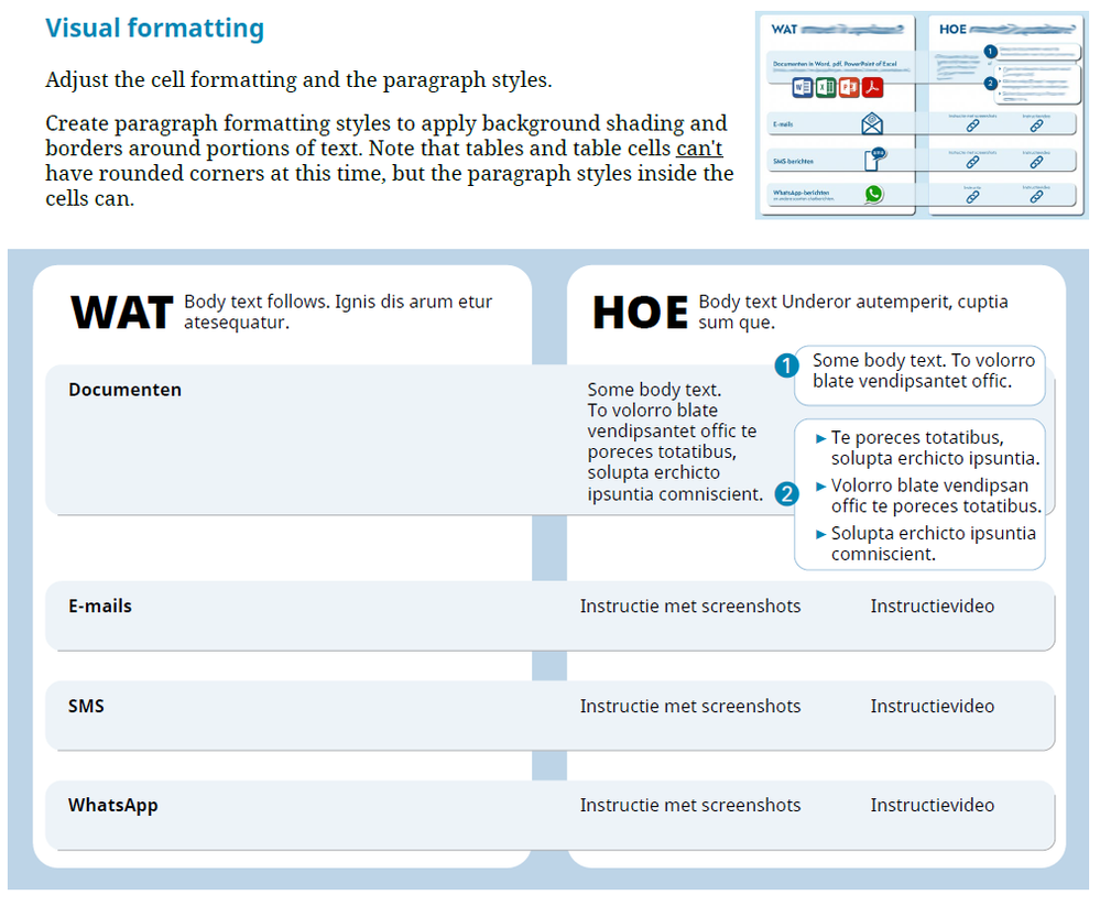

I like simplicity, but unfortunately, that doesn't work in more complex lay-outs, like the one below (I had to blur the contents for confidentiality reasons). Textblocks and colorblocks have to be disconnected, because reading order and layering (visual) order are not the same 😞
YvonS_0-1663167108448.pngexpand image
It's just an example, but this is what information designers encounter in daily life... Do you see a way to make this simpler?
Sep 15, 2022 Sep 15, 2022
Thanks for the detailed screen shot, @YvonS. It explains what you're trying to create.
Examining this from an accessibility viewpoint, you have a table of information that should be arranged in a spreadsheet matrix of columns and rows — there's the WAT column, and the HOE column that is further broken down into 2 sub-columns.
It really shouldn't be individual text blocks that you then have to wrangle into a correct Tag reading order and Architectural reading order.
A table structure is required because the user must be able to read down the first column and choose either Documents, E-mails, SMS, or WhatsApp, and then read across the row to find the screenshots or video instructions. This is exactly the correct functionality that a table structure gives end users. Plus, your reading orders are set perfectly!
I quickly created this sample that mimics your design (both the InDesign and PDF files are attached).
The key is that I created a table that sets the correct accessible structure for the content. And then I created Paragraph Styles to format the heck out of it. I heavily used the new Paragraph Shading and Borders settings in paragraph styles to create your design of the blue "hotdog" boxes.
By using Paragraph Styles to do the visual formatting, most of the text boxes are eliminated and your reading orders are left in tact. I did nothing to the PDF, other than to do the usual minor corrections to table span settings, which took all of 1 minute.
Ooops!
Here are the sample files.
Revised table sample to replace complex graphic.Revised table sample to replace complex graphic.expand image
