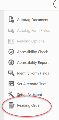

No--two different things. Reading Order is what you want. Did you check your Acrobat Pro Accessibility tools for the reading order?
