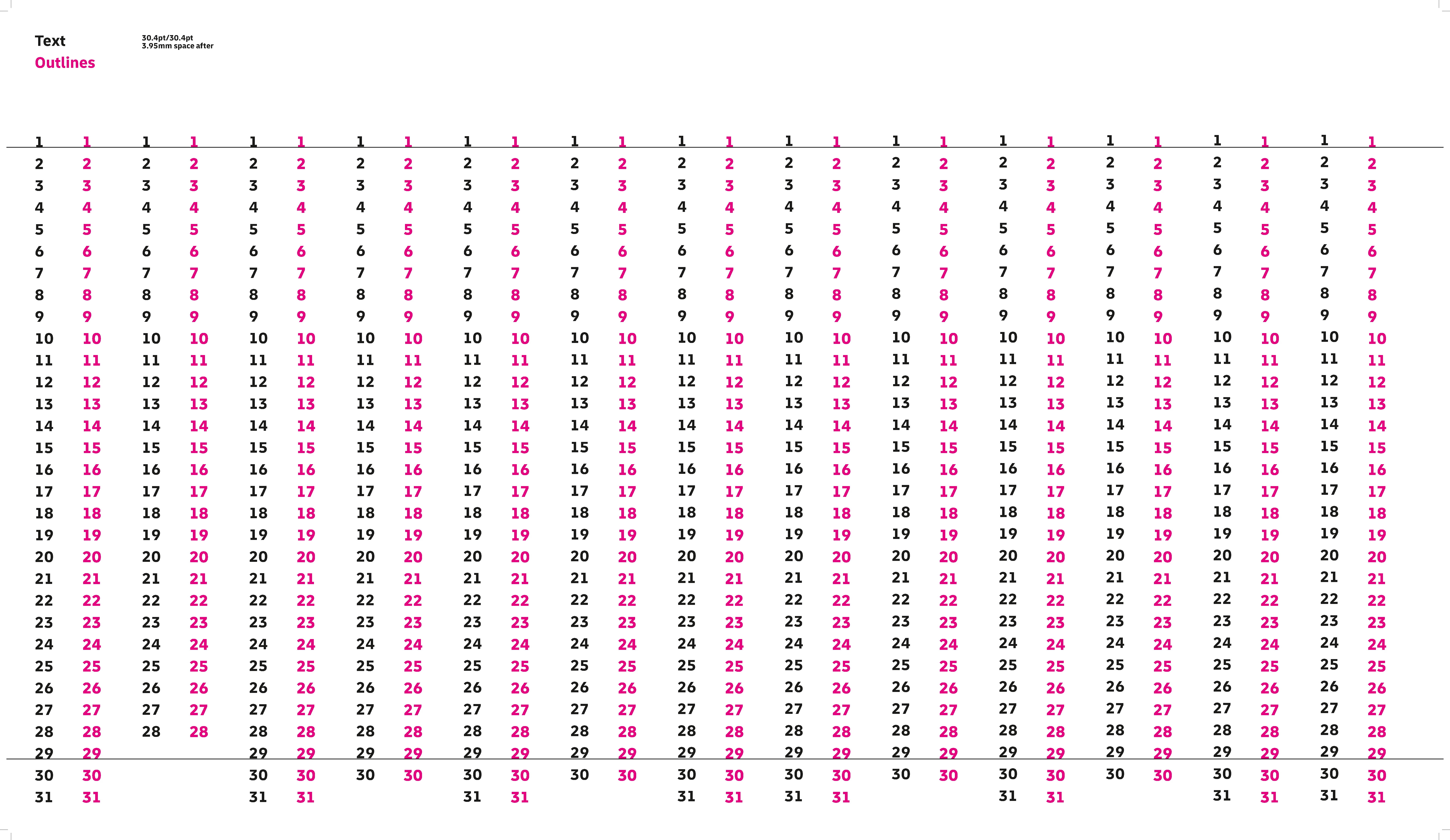

A colleague was working on a calendar and when I checked I noticed something strange, the text was slowly wandering up a little by little with every column you go to the right. I created a new file to figure out what was wrong and te same thing happened. Anyone have an idea what is going on here, apparently you can only use whole points for vertically spacing text otherwise this happens?
Tried different Indesign versions 19.x and 20.x and fonts. The only thing that fixes it, is either using whole points for all values or create outlines, then the alignement is fixed.
I added an Indesign file with a generic font so you can replicate what happens.

Hi @sndrmllr ,
well, yes, it's a known bug with InDesign.
What's your exact version of InDesign and your operating system?
The issue was certainly discussed here in the forum some years ago.
At first glance it seems to be the bug described in the thread I linked to below; maybe there is the same root cause:
Text in tables not aligned after exporting to PDF
Laubender, Apr 28, 2025
https://community.adobe.com/t5/indesign-discussions/text-in-tables-not-aligned-after-exporting-to-pdf/m-p/15293336#M622507
But your document is showing no InDesign table but more a "tabular" object, a text frame with 13 columns. The more columns, the more paragraphs are running through the text frame's columns, I think, the more the bug is visible.
Also for this kind of object the bug in PDF Export is known. I have to go back some years perhaps to find the relevant thread here in the InDesign forum. Ah, finally found the one from November 2021:
Problems with PDF Export in Indesign
maehrchen, Nov 05, 2021
https://community.adobe.com/t5/indesign-discussions/problems-with-pdf-export-in-indesign/m-p/12501088#M451973
See my test files still available on Dropbox:
https://community.adobe.com/t5/indesign-discussions/problems-with-pdf-export-in-indesign/m-p/12501527#M452019
Discussed in English:
https://community.adobe.com/t5/indesign-discussions/problems-with-pdf-export-in-indesign/m-p/12501851#M452043
And indeed, the solution (the workaround) was to export to PDF with the option "Tagged Text" enabled.

I output it on my Mac as a PDF/X-1a with tagged on and off. Did not see any drifting.
Can you upload a screen shot of the problem PDF just to be sure what we are looking for?
Also, what was the original font? Did you try it with your generic font?
sndrmllrAuthor
May 28, 2025
I just did the same. For me when I export a PNG, it looks like it looks in Indesign, and the PDF does not
May 28, 2025
I just used High Quality Setting only difference is the Create Tagged PDF setting  
Not Tagged
Tagged

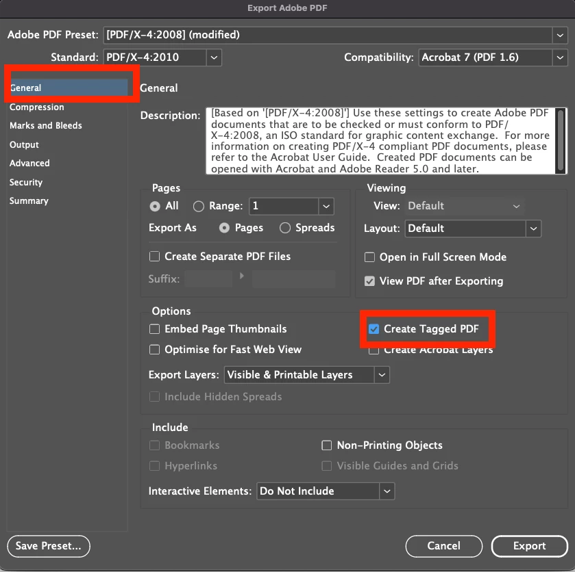

Eugene TysonCommunity ExpertCorrect answer
May 28, 2025
I tested it with different settings
When create with tagged pdf is not selected the issue occurs
When i tick this option the problem is no longer there
