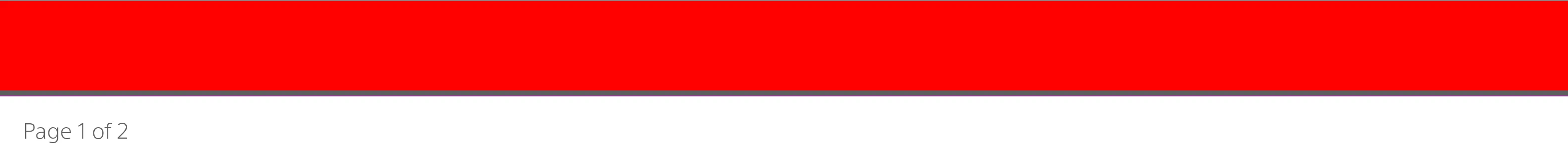

InDesign 16.2.1 showing red bar on workspace
Can't open more than one file in Indesign, get weird red or blue banner/line and when I scroll down the image lags and can't select certain files.
In my job, I have to get out multiple language files and it is easier to work in batches. How can I solve this as it is slowing down my work time!

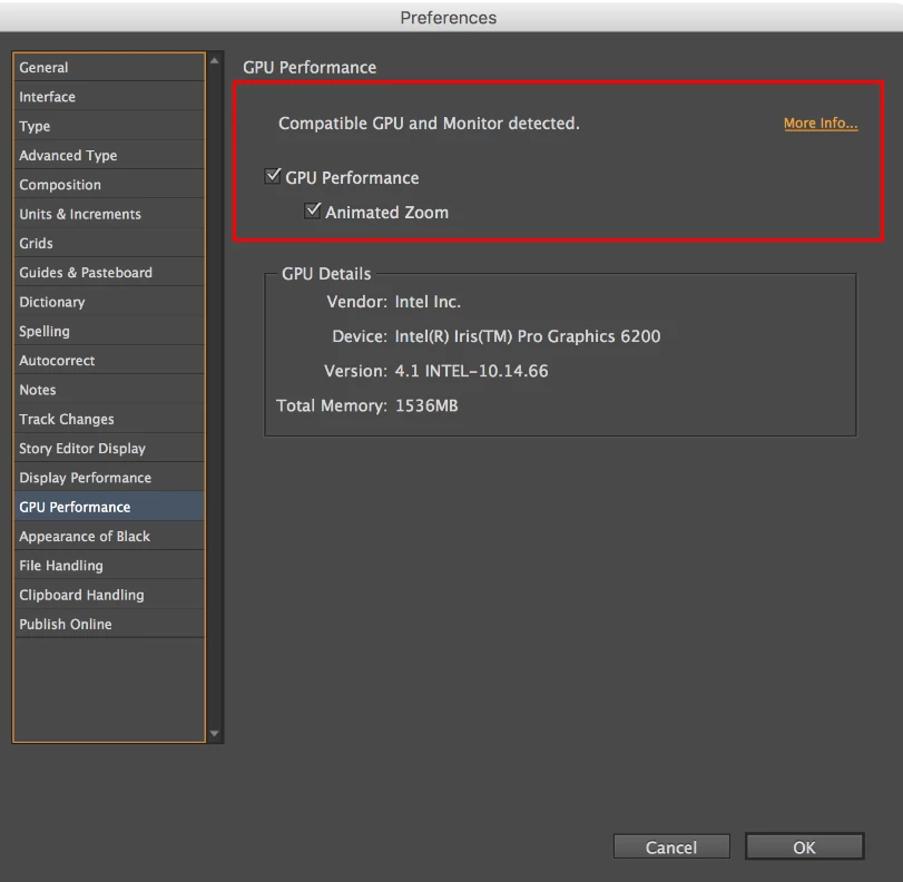

    Hi all,
    Sorry to hear that the issue is not yet fixed for some of you. We are still investigating this and need you help with a few more details.
    • Please share system information file by following these steps.
    • Exact version of InDesign in which you can replicate this behavior.
    • Is this issue happening with both GPU preview and CPU mode?
    • Screenshot of the “GPU Performance” from InDesign > Preferences >  GPU Performance like this:
    • Are you using external monitor(s)? If yes, with which port and cable combination it is connected.
    • During our investigation, we found that this is generally happening on the machines which are powered by eGPU. Do you have eGPU connected to your machine?
    • A small video demonstrating the issue could be really helpful.
    • Sample .indd document where the issue is reproducible.
    All this information will help us replicate this issue and help you accordingly.

    • Does turning off GPU performance as suggested by Bob helped resolving the issue?

    Are you using any eGPU and external monitor? NO eGPU, 1xMPX Apple Vega Pro II Duo - YES, external Monitor Displayport (otherwise i can see anything on a MacPro2019)
    Does turning on Appliation Frame (Window > Appliation Frame) helps resolving the issue? – i'm working in Application Frame mode – disabling Application Frame however helps to remove the red bars temp. BUT, as soon as I "tab" all open indesign windows/dokuments in one window and switch through them red bars appear again.
    What all applications are running in the background? – Photoshop, Illustartor, zoom, Spark, Finder, Safari.
    Does turning off GPU performance as suggested by Bob helped resolving the issue? – yes, as soon as i click gpu off.

    May 20, 2021 9:49 AM UTC
    Recently I've been getting this red bar that stretches across the top of my documents, and whenever it appears the document starts smearing. I've had a search but couldn't find anything that looked like the same issue. I've tried deleting my preferences but that didn't work. A short term fix is to re-open the same document (whilst it is already open), and it goes, but will come back eventually, but not neccesarily on the same document.

    May 16, 2021 10:33 PM UTC
    I have the same problem, that after a few minutes, after I switched between different tabs in InDesign, I get this weird red banner at top of the canvas. If so, I cannot select certain elements in the layout. However, resizing the window frame solves it for the moment.
    This keeps on appearing since the recent InDesign update – I’m working on an iMac with macOS 11.3.1 (Big Sur).

    May 16, 2021 4:54 AM UTC
    I updated my InDesign yesterday and now my book spread has this blue and red spashes of colour all over it and I can no longer work on my books. What is happening? Anyone else? Only using opentype fonts and one on Adobe's site.
    May 16, 2021 6:46 AM UTC
    Turn off the GPU performance
    Go to the InDesign Preferences
    greenstreet35
    Jun 16, 2021 10:59 AM UTC
    Working just fine when unchecking the GPU-box as suggested 👍
