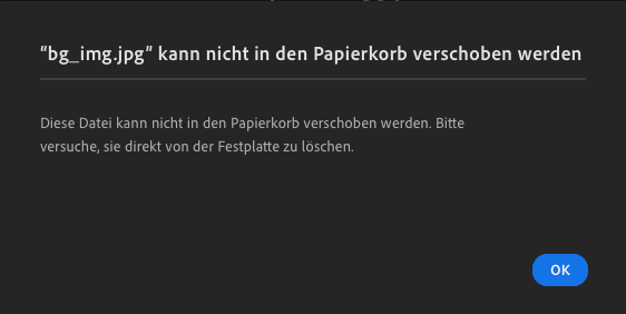

Switched to MacOS, LR Version 8.3.1 - still the same issue.Bildschirmfoto 2025-05-27 um 11.40.39.png

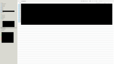

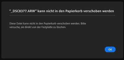

Bildschirmfoto 2025-06-16 um 12.08.34.pngBildschirmfoto 2025-06-16 um 12.09.58.pngSubject: Workaround Found for Longstanding Synology Drive Issue on macOS
Dear All,
Dear Rikk,
After being annoyed by this issue for the past six months, I finally — by accident — discovered a workaround. I wanted to share it here in the hope that it helps others who are affected.
For those using Synology DSM 7 or higher and the Synology Drive app (I'm on macOS), here's what worked:
Instead of accessing your NAS folder with photos via the native macOS network drive path, use the "Synology Drive" folder created by the Synology Drive app. You can browse this folder directly in Safari or Finder.
By default, this folder should be located at:
/Users/yourusername/Library/SynologyDrive-NAS_Server
When accessing your files this way, you can delete files without encountering the usual error prompt.
I sincerely hope this helps those of you who’ve also been struggling with this.
That said, I’m disappointed that Adobe hasn't addressed this issue more thoroughly. Some kind of acknowledgment or response from Adobe would be appreciated.
Best regards,
Miles
