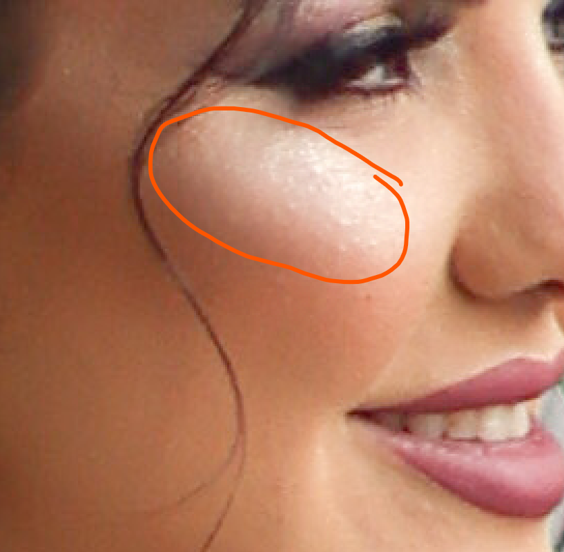

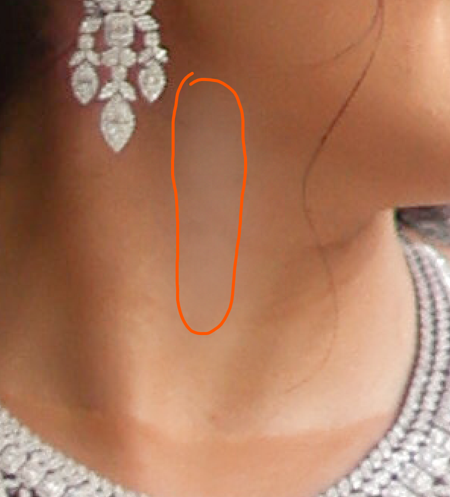

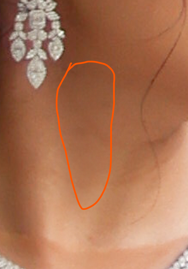

I will do my best to share a video. I will attach some images to start. It is happening for all images. But it depends on where you start your sampling.
Community Beginner ,
Jun 20, 2022 Jun 20, 2022
I hope the captions came through on those images. If not, please see the image filename. This is example one. There is an original image, then first stroke (greyish), undo, then second stroke (different coloration)

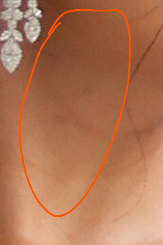

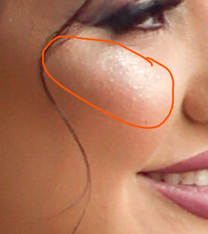

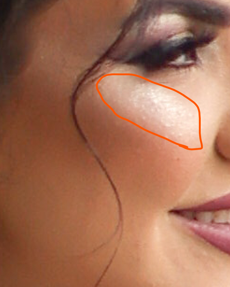

Example two. This time with a different area of interest, the brush is seemingly working better. pt2 - original.pngpt2 - first stroke.pngpt2 - second stroke.png
You can see in both examples that the stroke behavior is different from first stroke to subsequent strokes.
