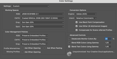

Thank you for your reply, here are my color settings;
Ps color settings:
Id color settings:
The CMYK settings are different, thus this might be the issues? I've changed both to FOGRA 39 as this is the printing standard in Europe. 

The color settings aren't really important here. What matters is the profile embedded in the file - this profile will override your color settings.
Problems happen if there is no embedded profile. That's when the working space comes in, as a fallback default. Then you might get differences - but this is not a problem as long as there is a profile (and policies are always kept at "preserve embedded profiles). Then the numbers get remapped from one into the other, and general appearance is maintained.

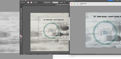

When saving my tiff file in Ps and then finalizing my file in Ai, should I be working in RGB document color mode, and then export as CMYK, or work in the CMYK color mode?
Seeing that my images are now RGB, they are displayed and exported in off colors if I am working in and/or exporting as CMYK in Ai. See the image below; from the RGB Ps tiff – to the same image loaded into Id with CMYK color mode – to the final pdf CMYK file;
While the image is naturally displayed correctly in RGB mode, it also ends up with the same greenish color once exported as CMYK, thus highlighting my core issue.
Now that being said, the issue is less apparent in Id, yet here I have no option to choose between CMYk and RGB when exporting the file via defined presets, unless I export as jpeg where I am then given the option; and when doing so, my RGB file is perfectly converted to a CMYK file without any color loss or change.

You write: " While the image is naturally displayed correctly in RGB mode, it also ends up with the same greenish color once exported as CMYK, thus highlighting my core issue. "
How are you viewing the CMYK image? is it looking green when displayed in Photoshop?
Of course if you make a print, then the printer profile accuracy comes into question.
BUT there's no way converting an RGB (desaturated) image to CMYK using a good FOGRA39L based ICC profile should produce an on-screen image [on a well calibrated/ profiled display] with a cast.
Euroscale Uncoated, wow that’s an ancient ICC, I'm really surprised anyone's still using that.
Please tell us where you are seeing this green cast?
