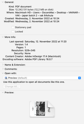

+ here are the details of the original scan, i.e. the image which was modified and then used for the jcard:

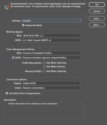

Thank you for your reply, here are my color settings;
Ps color settings:
Id color settings:
The CMYK settings are different, thus this might be the issues? I've changed both to FOGRA 39 as this is the printing standard in Europe. 
Could you explain the desaturation step? It results in the image looks reddish, and it stays red when importing into Id or Ps, is this intended?

Nov 15, 2022 Nov 15, 2022
The color settings aren't really important here. What matters is the profile embedded in the file - this profile will override your color settings.
Problems happen if there is no embedded profile. That's when the working space comes in, as a fallback default. Then you might get differences - but this is not a problem as long as there is a profile (and policies are always kept at "preserve embedded profiles). Then the numbers get remapped from one into the other, and general appearance is maintained.

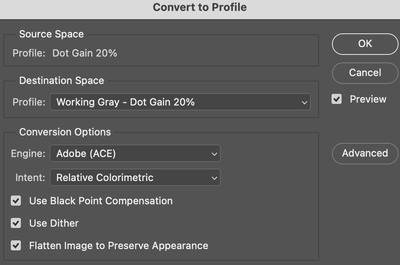

To start, in Ps I am using....
Color space: RGB and FOGRA39
Source space: dot gain 20% profile
Destination space:working gray 20% dot grain profile
Don't ask me why my destination space is a working gray profile rather than sRGB. This could be the issue. Attached below is my current convert to profile window;

Why FOGRA39? Your print provider provided this for you?
