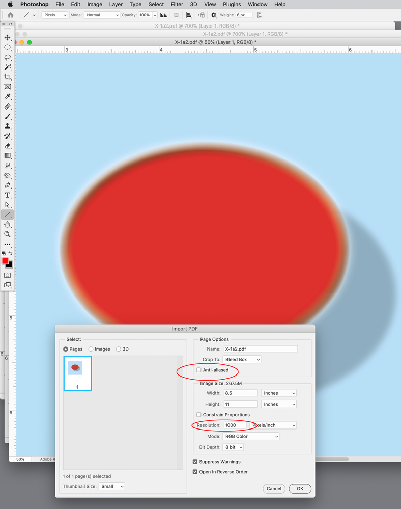

Hi @Jo25002566w0to , As @Stephen Marsh suggests the lines appear at low resolutions when anti-aliasing is applied to the edges of the flattened boundaries. They wouldn’t print from a high res RIP because there would be no anti-aliasing on RIP’d output. So a solution for flattened PDFs would be to open the PDF at a high resolution with Anti-Aliasing turned off, and then downsample to the desired resolution—it would be easy to make an action for that.
Here’s a PDF/X-1a opened at 72ppi with AA checked, and the anti-aliasing is clearly visible:
The same with AA unchecked:
Opened at 1000ppi with AA unchecked:
Downsampled to 300ppi:

Try this script:
https://shared-assets.adobe.com/link/b9296b5d-b475-4488-4694-84439322696e
var res = 300
var inputFiles = File.openDialog("Choose the Input PDF File", "*.pdf", false);
var po = new PDFOpenOptions();
po.cropPage = CropToType.TRIMBOX;
po.antiAlias = false;
po.resolution = 1200;
po.mode = OpenDocumentMode.CMYK;
po.suppressWarnings = true;
var doc = app.open(inputFiles, po, false);
doc.resizeImage(null,null,res, ResampleMethod.BICUBIC)

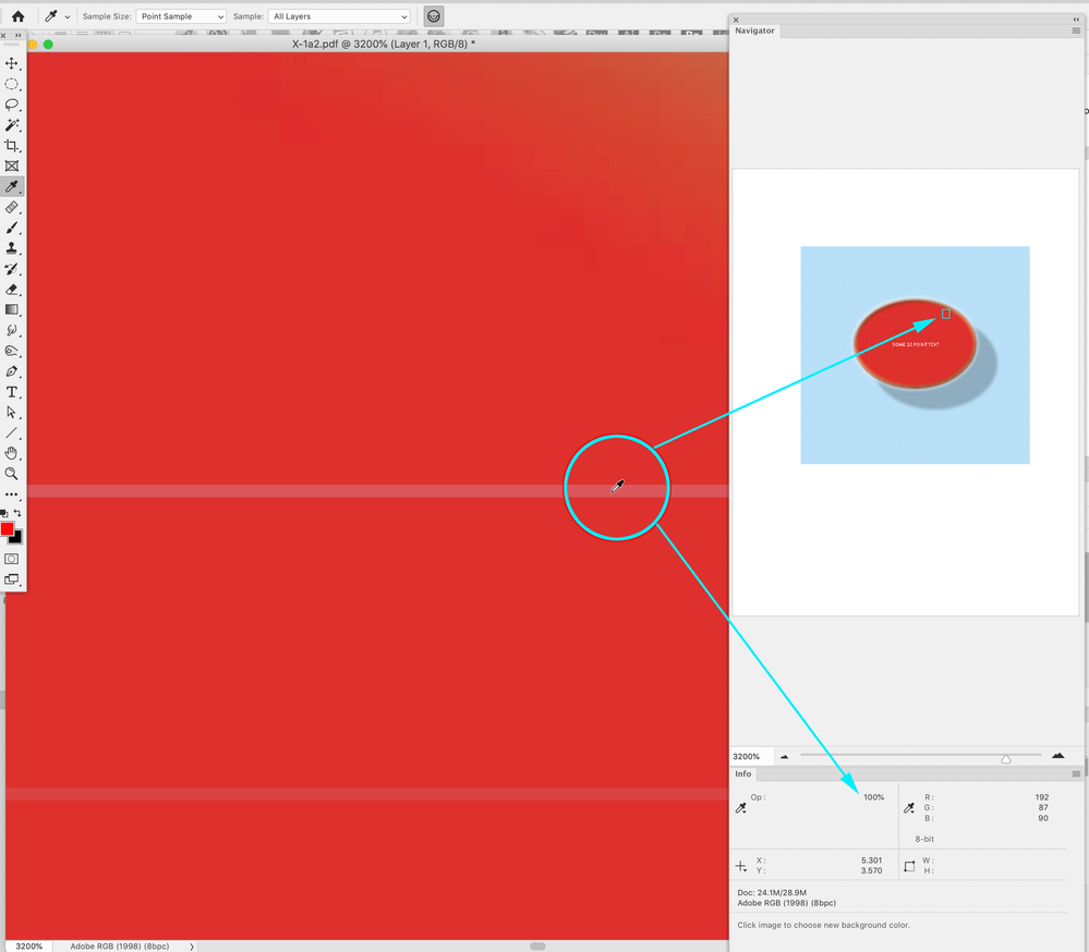

Also, the "Stitch" lines in my (flattened) PDF/X-1a have no transparency—if I sample a pixel on the line it reads as 100% Opacity. So, I wouldn’t expect applying the image to itself would affect the 100% opaque color?

Thanks Rob, it's not you, that PDF doesn't work with the method of applying or layering the image multiple times... Oh well, looks like oversampling with AA off and then resampling down is the answer in this case. I thought it was a general approach, however it looks like it may only work with certain files.
I just checked Acrobat Pro DC 2022 and Adobe have NOT fixed the lack of anti-aliasing on exported image files, resulting in a substandard result compared to rasterizing in Photoshop (it does remove the stitch lines though, but it butchers the 10pt type).
