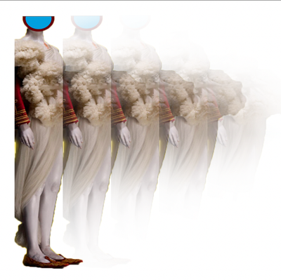

Hello, I am looking back at some old work I made in 2016 and I remember using the smudge tool to achieve these semi-transparent 'clones' of the object I was smudging. I've played around with strength jitter and spacing, but I'm unable to recreate the clean, spaced out smudges that replicate the object (but faded). In the upper left I recreate parts of the figure with generous spacing, and then towards the middle I have a few faded copies of the blue diamond illustration.
I'm attaching the images with arrows pointing to the effects I want to recreate and also the failed attempt to recreate it (the ring on the bottom right). Any help would be appreciated, even if it's using another tool. I would prefer to use the smudge tool so I can "paint" around with this effect.

@Trevor.Dennis Ok thanks! yeah this was done in 2016, I'm probably off about the diamond. But what about the other figure on the top left, that seems like it could've been done with smudge? Basically what I want to do with the smudgle tool is get really spaced out smudges so they aren't all blended together - like a ghosting effect (is that the right term?).

@Trevor.Dennis it would also seem that this method would make it possible to duplicate parts of that diamond drawing in the image without using the clone stamp? I was just fiddling around in photoshop with an image and you see I'm getting closer (using just smudge tool) (attaching image).

AFAIK the smudge tool will only move pixels, and not copy them.  I even tried adding the Alt/Opt key as a modifier, (try it yourself).  With careful control of the brush size with a fully soft preset, and careful control of the start position of the stroke, I could get a sort of ghost effect, but the ghost is always on top of the copied pixels, and never underneath.
Ah HAH!!  I've cracked it.  You have to look at it back to front, so the lower right ghost was the original.
The smudge tool preset was fully soft and about twice the size of the selection. Strength was 100%.
I made a selection that encompassed the original, and dragged up and left, but reversed the stroke about half way.
I am going to have to do this again to be sure I have this right
I am not entirely confident I can do this again, but this is my starting point
Hmmm it wasn't working, but then I remembered I gave the selection a hefty feather.
Try again.  I think I should have used a larger brush size for the smudge tool.  You can just about see where I finished the stroke before reversing it.
It is very sensitive about the selection size and where you start the smudge too stroke.  It was interesting trying to work this out, but the bottom line is that there is an easier and more consitant way to the end result.
