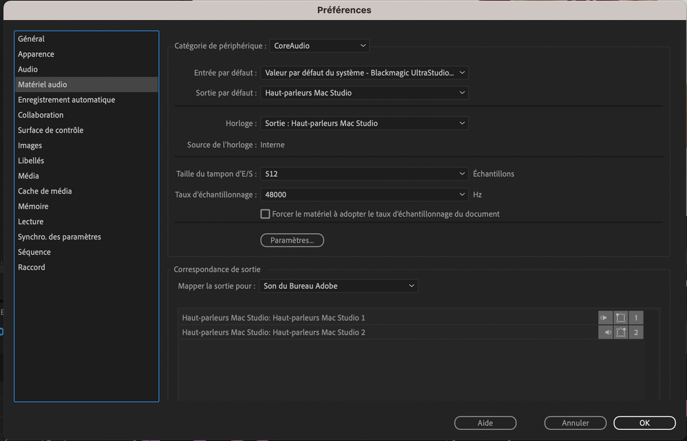

Hi all
For many times the same problem with this configuration :
MAC Studio 2022 - Apple M1 Max - 64 Go - Black Magic Ultra Studio 4 K Mini - Adobe Première 22.6.4
Video Output Blackmagic SDI to JVC Monitor
Problem : - video freeze on the JVC monitor ( video output ) after working 30 min
- Adobe is also blocked. Saving is possible but no repons on the timeline of the project. ( space bar non repons to play the video )
Issue : changing set up on preferences
Audio material : Output - HP MacStudio ( no Black magic )
Correspondace output : same
Lecture : audio output Black-Magic - video output : black magic.
And it WORKS 🙂  Hope it is the same for you all. Kind regards - Philippeaudio material.pngaudio lecture.png
