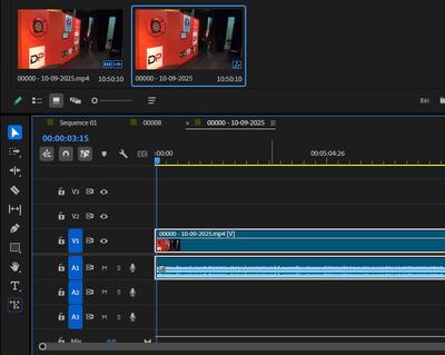

Hi, been reading through this and, despite being on 25.5 .MTS files are still problematic. They never used to be though. About 6 mths ago it was all fine, then something changed and its knackered it.
My scenario is that if I play .MTS in VLC player the audio is fine. In Premiere it doesnt even bring in the audio to the timeline if a clip is dragged & dropped from a bin into a new timeline. I've had this with other video clip formats and, oddly, if I "New Sequence from clip" that does create a video and audio track which I then have to cut and paste into my first timeline. It's clunky and moreso a workaround than a solution.
This also happens if I create an entirely new project and use the Import Wizard as another post suggested.
Interestingly, the same happens with Resolve.
Why can VLC handle this but not pro-grade software?
Advice welcomed.
Cheers,
Lu
Contributor ,
Sep 13, 2025 Sep 13, 2025
SOLUTION:
Spank it into Handbrake, convert to MP4, and you're golden.
Results in
But this shouldn't be the case. I shouldn't have to use free software to fix a shortcoming from a paid for, premium grade software.
