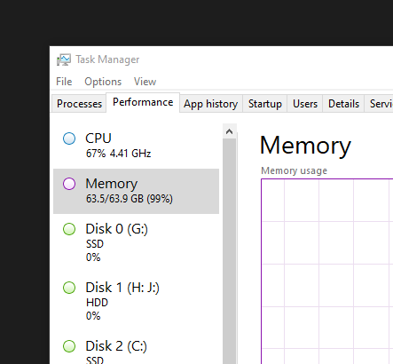

  Hi Adobe,
I haven't contacted you in a long time....first let me praise you, you can see that you are working hard and every iteration of Pp is better and better....until this v25.4...the problem is that the new version 25.4 'eats' memory....
T he system is Win 11 pro, freshly installed with all updates (24H2 - Os build 26100.4946),
graphics driver (580.97-desktop-win10-win11-64bit-international-nsd-dch-whql)...
deleted (Media Cache Database, Media Cache Files, deleted rendered files from Adobe Premiere Pro Video Previews) from previous renders
  Kreativ cloud installed.....mostly, when I render a video on the timeline the memory goes up and up until it reaches 64GB, as much as I have and everything stops, even the OS...must restart the system(hard,everything is frozen)...so I was forced to restore v.25.3 and the same I rendered the project,delet (Media Cache Database, Media Cache Files, deleted rendered files from Adobe Premiere Pro Video Previews) and...
memory does not exceed 32GB or 48% of memory usage....
my configuration;
RTX 3090TI 24GB
Ryzen 9 3950X
64GB memory
1NVMe M.2 for Os
1NVMe M.2 for video
1NVMe M.2 for cache....ect
thank you very much and all the best

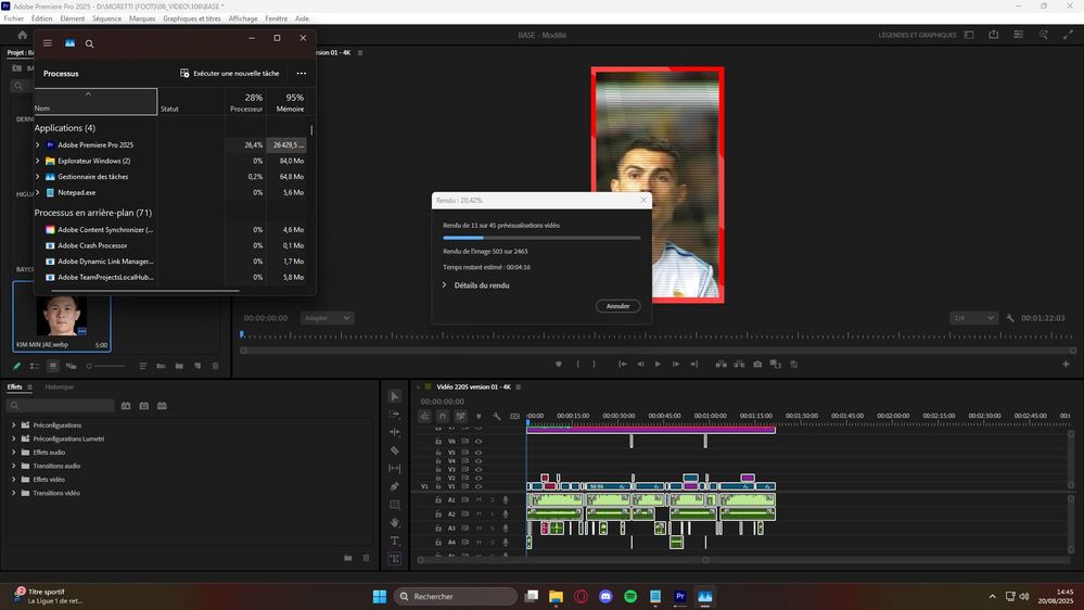

Hello Everyone !
For the past two weeks, I've been experiencing significant slowdowns (and even crashes) when rendering in Adobe Premiere Pro.
At first, I thought it was due to excessive heat since it's summer, and I figured my PC was struggling and that it would pass, but now the temperatures have dropped and nothing has changed...
During rendering, I went to the Windows Task Manager and saw that memory usage is still very high (95%). I don't know if this is normal, but I find it excessive considering that I have a fairly new PC with:
- 32 GB of RAM
- Intel Core i7-14700KF
- NVIDIA GeForce RTX 4060 Ti
I checked the “GPU-accelerated rendering” box to help the processor by using the graphics card. Of course, during rendering, I don't do ANYTHING in the background, I just let the computer run, and yet this happens to me when rendering TIKTOK videos, which are 120 seconds long at most.
It can sometimes take me up to 20 minutes for a 60-second video with a few video clips and images, whereas before it took 120 seconds to render. As you can see above, I have the “RAM available for Adobe Premiere Pro” option at 26 GB. Is that too much? Is that what's consuming too much and causing the rendering to crash?
PS : Of course, I have the latest updated version of Premiere Pro and my drivers are also all up to date. And sorry guys for my english, it's not my native langage.

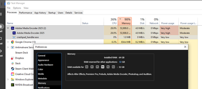

Throwing another datapoint into the ring...
  • Windows 11 24H2
  • Intel i5 13600k
  • GTX 1070
  • 64GB RAM
  • Attempted exporting to both a local nVME SSD and to an external NAS, both with terabytes of free space
Sequence is just over 1 minute at 2160p50, all media is Sony XAVC-L.
This issue appears to only be affecting sequences containing a significant number of After Effects MOGRTs for me. In my case the sequence is 100% covered in MOGRTs from start to finish.
I've exported other sequences with far longer durations without issue that only contained a few or no MOGRTs without issue.
The export proceeds normally until it hit about 60%, with RAM gradually climbing to 100% through the process. The export then appeared to get stuck at ~60%, after which RAM occasionally dropped to 95% before rising again and progressing a few more percent. It would then present an error message which was different every time. Occasionally my entire display would black out. The last error message I got was:
Component: Apple ProRes MXF OP1a of type Exporter
Selector: 17
Error code: -1609629695
(Sorry I did not capture the full text.)
Closing the export failure message did not free up the RAM, so subsequent attempts at exporting fail even sooner.
Downgrading to 25.3 allowed me to export the sequence.
