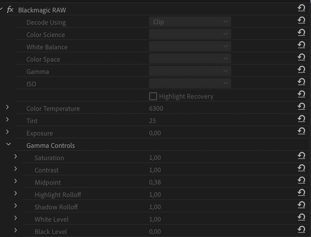

For some reason my master settings for a braw-clip are greyed out from time to time. After a restart it's mostly solved for some time. Is there any setting I don't see to solve this?

I am still running into this problem so I wanted to post a workaround that seems to solve the issue (at least short-term for me).
1. Hit the reset button on the Blackmagic RAW tab.
2. Click out of the source settings for your braw clip (I toggle to the window that shows transform properties.
3. Click back into the Source settings for your clip.
  • For me here, Decode settings is now available, and can switch between metadata and clip.
4. Set Decode using to Clip
  • This turns your video into red and black stripes in the program monitor, but ungreys the "revert to metadata" button.
5. Click "revert to metadata".
Once I finish my raw adjustments, I'll usually hit "Update Sidecar" to create a metadata file that can be edited in textedit. This is also useful if you need to send your clips over to after effects using dynamic link, but don't want to lose all your metadata settings.

Dec 06, 2021 Dec 06, 2021
This works for me in my current project.  My "GAMMA Control" selections were gray prior to this.
Change your 1st "Gamma" selection to one of the Blackmagic selections such as "Blackmagic Design Custom".  It doesn't work for "BM Video".
