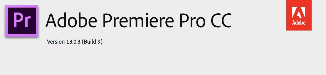

You're using the current version 13.0.3?
Explorer ,
Apr 02, 2019 Apr 02, 2019
Yes 13.0.03. ( and paid...)
I still have on my Mac and old demonstration version I don't use any more (CC 2017). Could it interfere ?Premiere.jpeg
